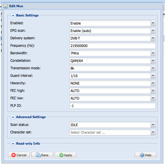

    The are 6 muxes for my area (Melbourne, Australia) I have been able to get the expected channels on all muxes except one. The misbehaving mux will not tune any channels no matter what I try. I ran w_scan with the following command
    w_scan -ft -c AU
    and it found all expected channels on all mixers (see attached txt file), so I can't understand why it won't work!
    As far as I can tell the settings for the mux in TvHeadend appear to be correct (see attached screenshot).
    Is someone able to help? Thanks in advance.
