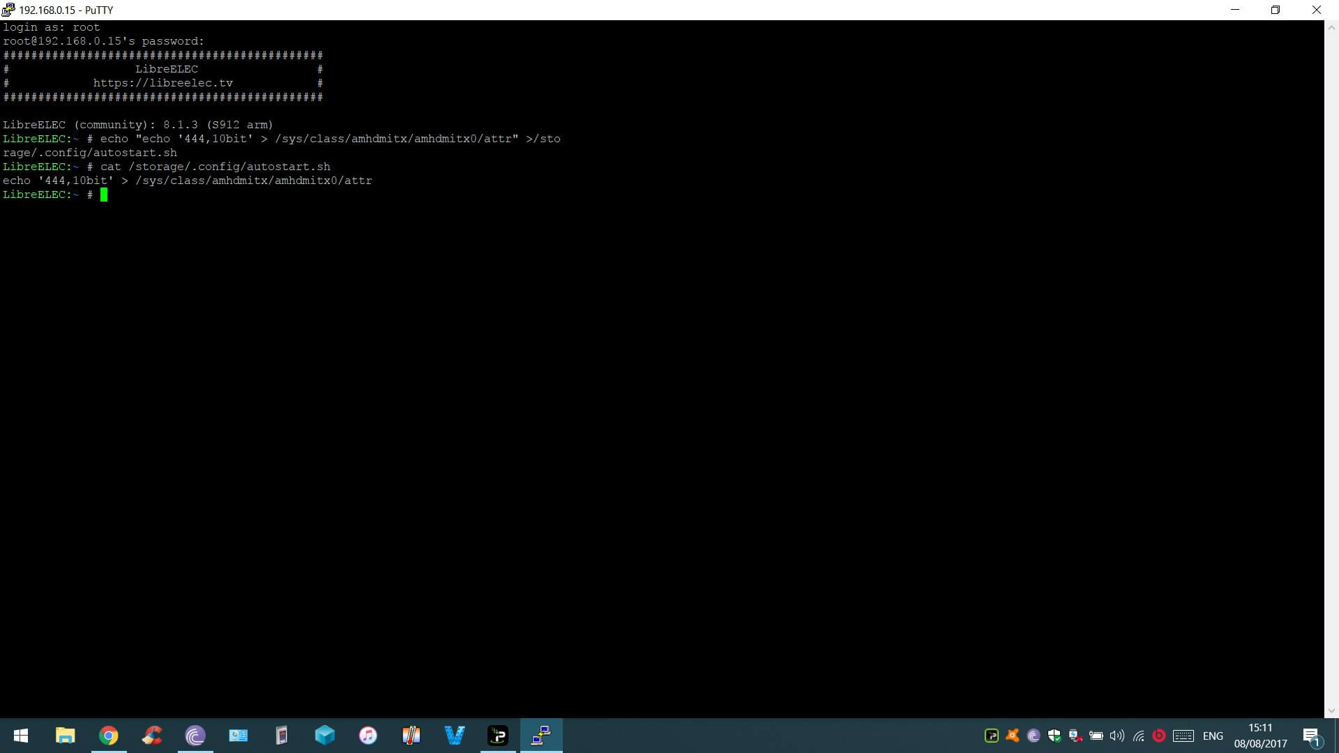

  • I know I need to use ssh.. I've downloaded putty and I can connect to my s912 device using the ip address and username :root password: openelec but I do not know how I run the command and put it in the autorun folder?
  • Code
    echo "echo '444,10bit' > /sys/class/amhdmitx/amhdmitx0/attr" >/storage/.config/autostart.sh
    Run this command only once or command will be called multiple times (no harm probably).
    Check file content with
    cat /storage/.config/autostart.sh
