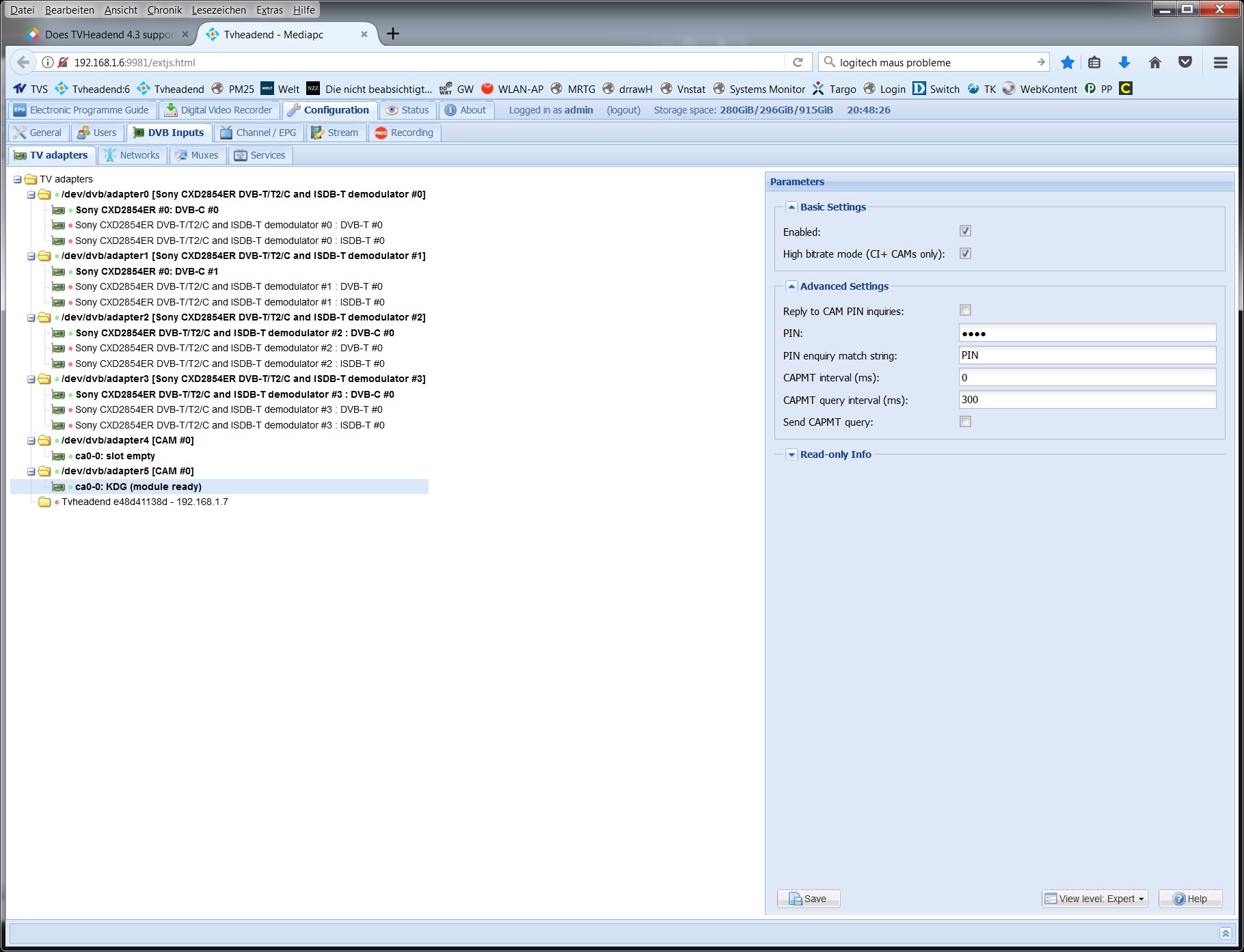

Display Moretvh supports CI modules.
tvh 4.3 has implemented CI support for DigitalDevices CIs.
Works (mostly
flawlessly.....
Unfortunalty other devices or not yet implemented.

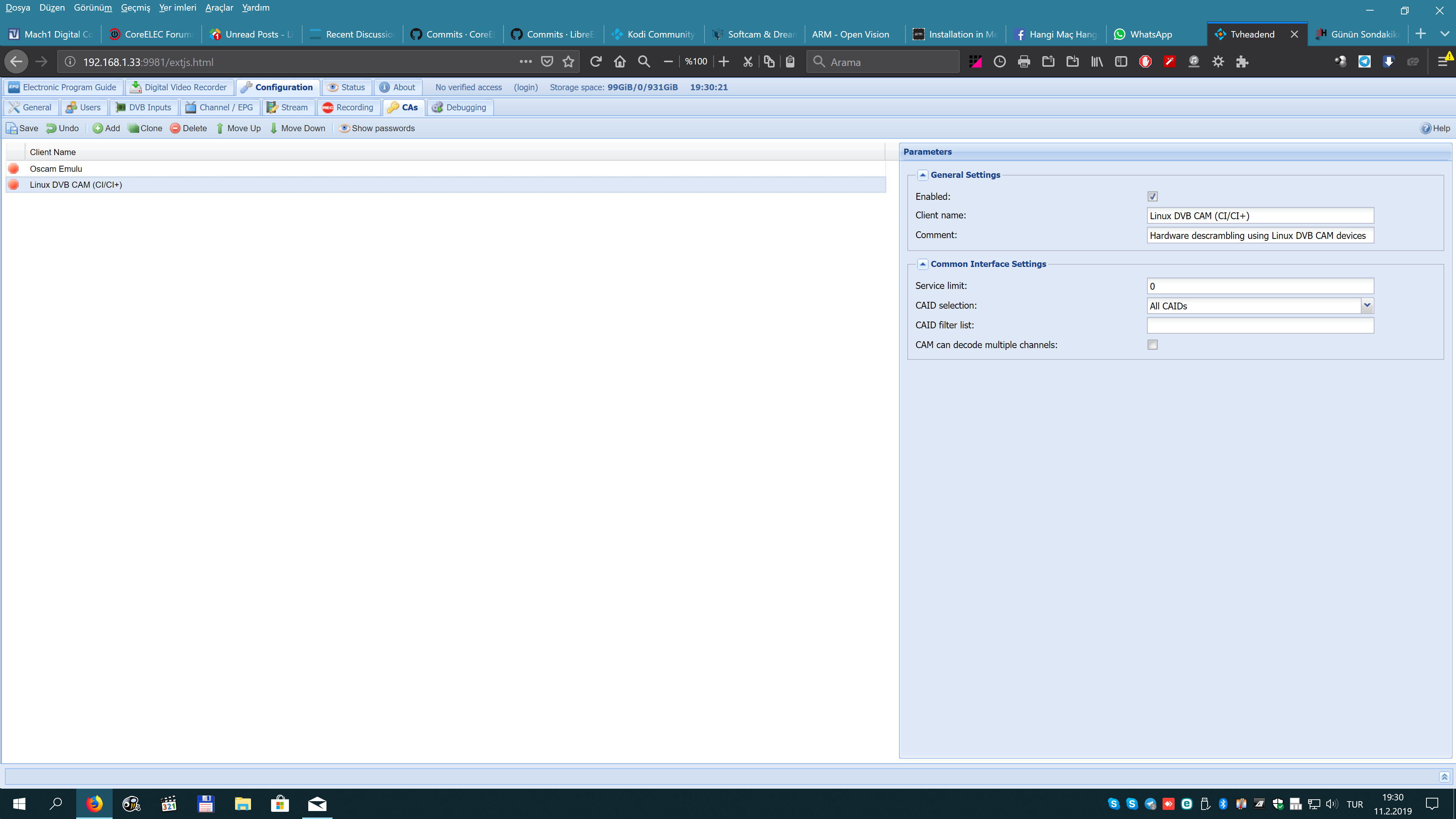

Greetings,
The problem is this: In the TVHeadend versions of LibreELEC I installed on the computer, the CAM tab of the USB-Tuner is activated.
But in the TVHeadend Editions of ARM Boxes (Mecool K1 Pro, WeTek Play 2), the CAM tab in the USB-Tuner section does not appear.
If this CAM Tab is displayed, the problem will be solved, but I don't know how.

Hi
I was the same problem. My tv tuner is Technotrend CT2-4650 CI, Libreelec 9.0.
It turned out that was Tvheadend problem. I downloaded from tvh-le9.0 latest nightly build and CI slot started working, also "ca0" appeared in Tvheadend tv tuner's list like before.
Regards Arek
