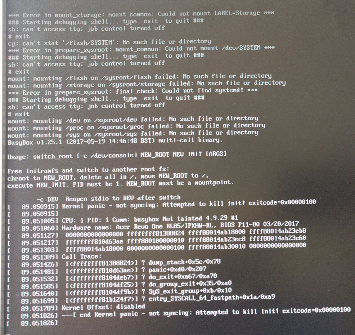

  • Got a really cheap Acer Revo RL85 with Haswell Celeron.
    It has a PCIe based SD-Card reader on the top.
    I installed latest LE onto an SD-Card but inserted it into the SD-Card reader and rebooted.

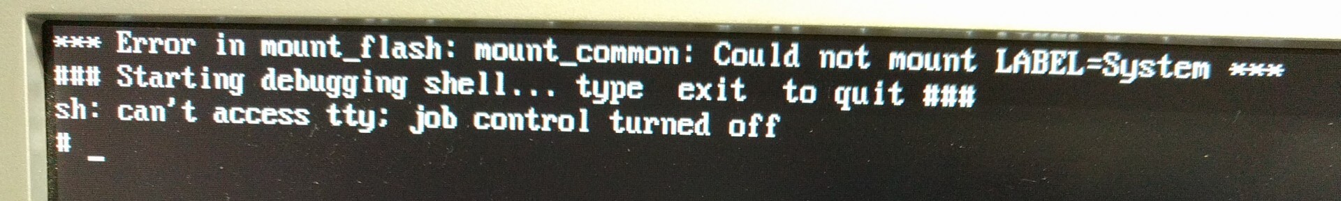

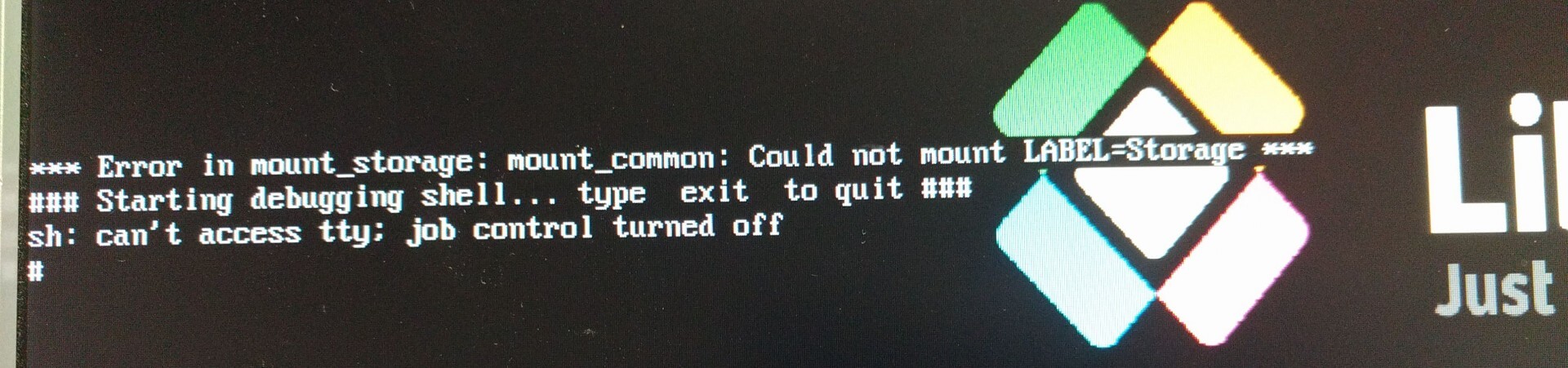

    After a few seconds, I get :
    I type EXIT and get this:
    If I keep entering EXIT, it eventually panics and crashes:

    ^ looks like a 4GB card device being detected.
    The error is clear in the first two images. The syslinux.conf or extlinux.conf is configured for boot=LABEL=System and disk=LABEL=Storage and those partition labels do not exist on the boot device. It should be using boot=UUID=blah something like below:
    DEFAULT virtual
    TIMEOUT 50
    PROMPT 0
    LABEL virtual boot=UUID=2605-0052 disk=UUID=c1d54db6-83d0-4a9e-b662-e7099f9edbf0 quiet tty vga=curren
    So i'm wondering if another bootloader and traces of an older OE install are present on the 1TB /dev/sda device? - because using disk labels in the boot config is how things used to be done. LE has only ever used the UUID method.
