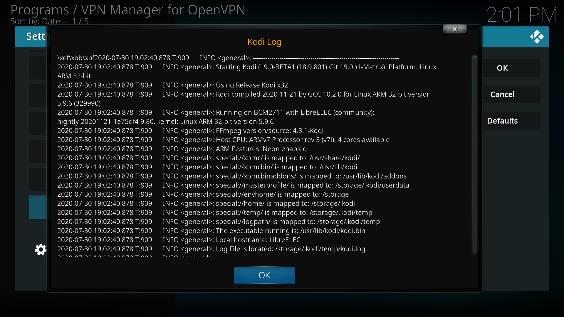

  • MikeKL can you edit /storage/.kodi/addons/service.vpn.manager/libs/logbox.py change
    log_file = open(getLogPath(), 'r')
    to
    log_file = open(getLogPath(), 'r', errors='backslashreplace')
    It's on or around line 57. There are multiple versions of this line so please check you're in within the function which starts def popupKodiLog():
    I don't know whether you're a Python coder or not, but don't mess with the indentation or tabbing, just add the extra parameter within the brackets.
    You don't need to reboot or reinstall, you can just go back into settings and use the display log option again.
    When you've done this, it'll hopefully display your log. Please take a look at it - you should see some characters that are backslash escaped, but the log should still be very much readable. If you can't see any but the log is good, then no probs.
    If you can't do this, I'll need to spin a build, but family stuff is happening first today.
  • zomboided I directly edited line within logbox.py as suggested and kodi.log is now correctly presented when using add-on option. :cool: (with backslash and characters "begining of log only" which are not distracting and easy to ignore)
