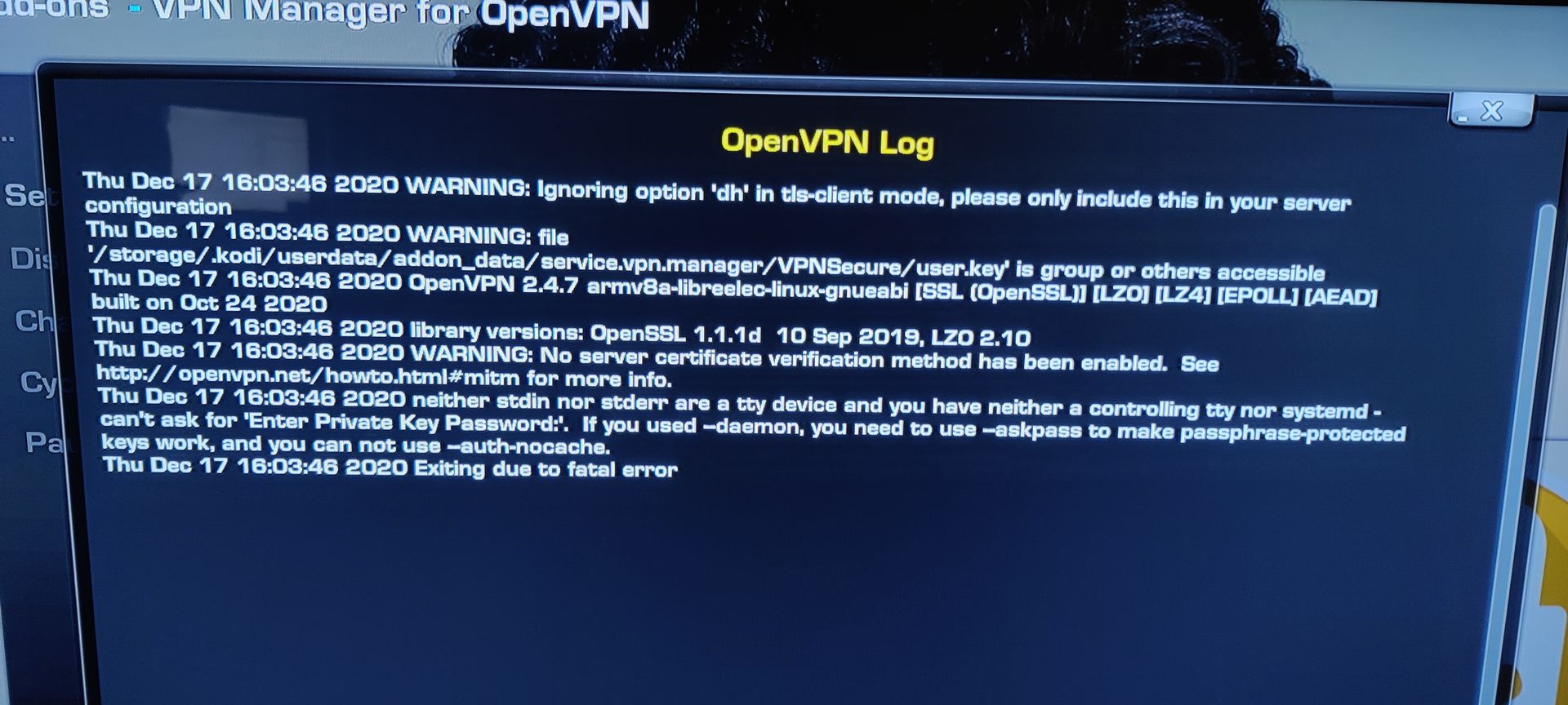

    Hello Zomboided
    I tested the VPNSecure with the file (6.4.2) you provided, it gives an error. Error screen in attachment.
    Everything seems ok with the files but the template.txt is different then before.
    I added these files also in the attachements.
    If you need other Log-files please let me know and where to find them in folderstructure. Couldn't find the openvpn log anywhere?
