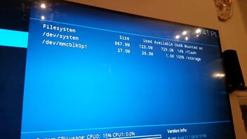

  • This is update to my previous post.
    Please take a look at the partition from the attached picture.
    It looks to me that the internal storage is full.But why?
    /dev/mmcblk0p1 27mb total, used 26.3 and free 1kb 100% used
    then external (original card is 29.6 gig) after creating LIBREELEC_disc with the LibreELEC USB-SD Creator size became small and stays small at 867.8mb
    /dev/system total 867.9 mb 123 mb was used and free are 729mb is only 14% used. ( he still should be able to use this one)
    My conclusion is; either the unit is redirecting new repos only to internal storage (and from KOPRajs post: after creating disc image the device should use external storage) since external has some space.The other problem could be that the external should have different name not /dev/system/
    I'm hoping to someone point me in right direction.
    Can someone please post the screen shot of filesystem with external storage to be used for repository files.
    Thanks in advance

    My problem is different, the unit will boot no problem (is empty LIBReElec)but is no more available storage to load repos.Please take look at my screen capture
  • I'm afraid you are making false conclusions here. Let's make it more clear:
    - /dev/system - this is internal read-only partition with system files (that's where LibreELEC or Android is installed)
    - /dev/data - that is internal partition used for storage (it is not there because you are not using it)
    - /dev/mmcblk0p1 - this is first partition on your SD card
    - /dev/sda1 - that would be first partition on your USB drive
    Now please try again to create the storage on SD card or USB drive using the storage.img.gz with LibreELEC USB-SD Creator and see if it gets correctly resized to the size of your device upon first boot.
  • Thanks for your reply.
    /dev/mmcblk0p1---- 27.0mb is very small in my brother's case.Can it resize with partition program only and should work fine?
    how many partitions after properly making storage on sd card we should see?

    It seems that the partition did not get resized.
    I've made some changes and re-uploaded the storage.img.gz. Please re-download and try it again. Hopefully it will get resized this time.
