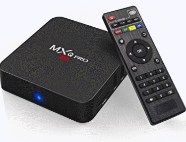

  • First, let me say THANK YOU to ippon for this work. It is people like you that make the difference between happy users (with a remote that works) and grumpy, dejected users.
    I bought a Henscoqi MXQ Pro 4 from Amazon to try and run LibreElec. (S905x/Penta-Core Mali-450/1G/8G). LibreElec booted from the SD card but only the power button worked on the remote. After reading (and re-reading) your instructions, I now have a fully functional remote. THANK YOU AGAIN.
    For those of you who bought a similar box, here is the remote.conf file you can try...
