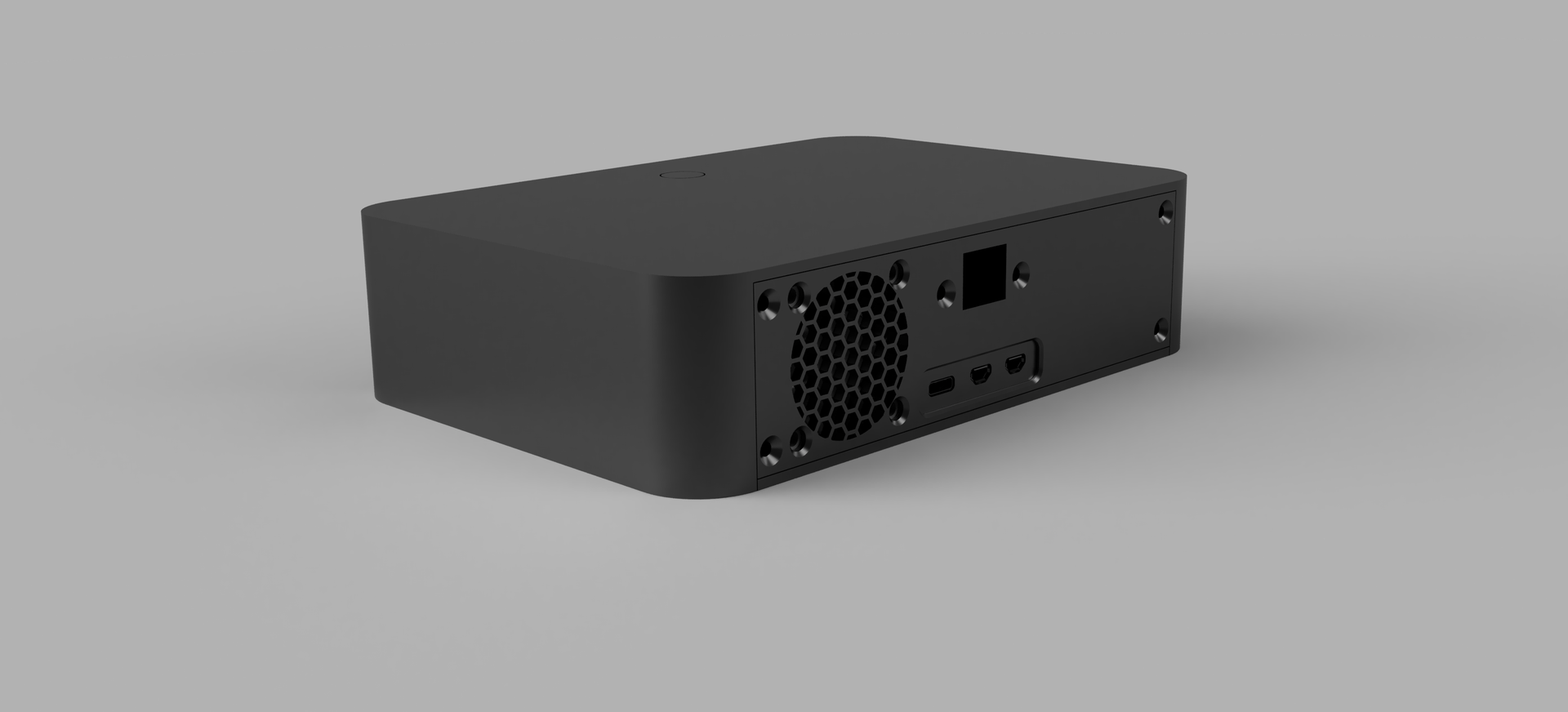

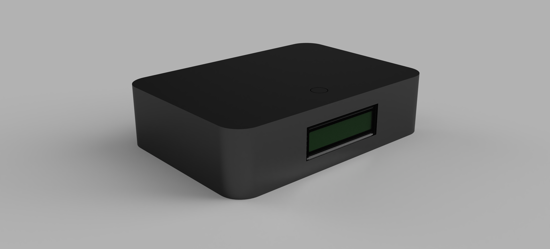

    After some pondering, that may be the best option; sell the x86 stuff and get a Pi 5 instead. Shame I can't use the hardware I currently own, but I'm already thinking about designing a case with an integrated 16x2 LCD and IR...*launches Fusion360*
