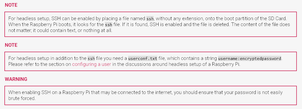

  • Wrong directory i think...
    If I connect the SD-card to my Destop PC it shows up a partition called LIBREELEC looking like this
    There should the ssh and the userconf.txt files go.
    And you have to encrypt the password with openssl
     openssl passwd -6

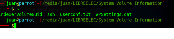

     openssl passwd -6
    1) I already have ssh file and userconf.txt inside the LIBREELECT
    2) I edited userconf.txt with root:libreelec (cipher with openssl)
    3) I made a Nmap Scan and can see my Libreelec
    4) Now ssh [email protected] ... and I get a conection refused
    5) I try in windows with putty and I get a conection timed out
