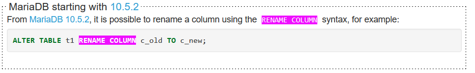

Looks like SQL is poorly formatted in Kodi. It appears it was introduced in PR #19578 upstream. There may be other SQLs that were reformatted with similar issues.
You can try applying this patch and spinning your own build of LE:
