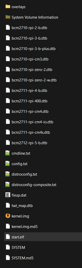

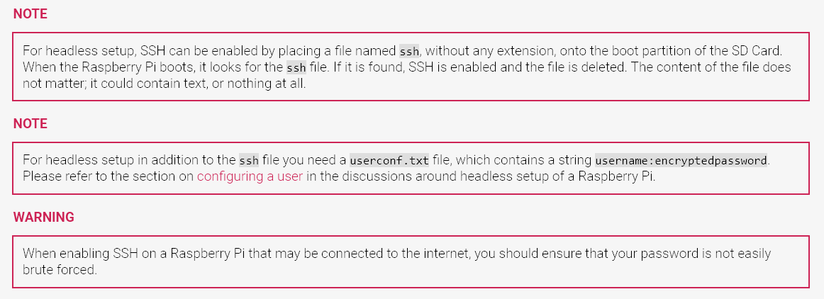

This information above is for Raspberry Pi OS, really doesn't apply to LE. The easiest way to turn on SSH is just connect the RPi to a monitor that is working with it, go into the LE Settings app and turn it on. The alternative way is to add " ssh" to the end of /flash/cmdline.txt, you should be able to find instructions on the forum (no quotes, add to the end of the existing line in the file).
Arghhh... Sorry, i mixed it up with my PiOS installs
You can enable easily by opening the sd card from another pc
Manual can be found here
