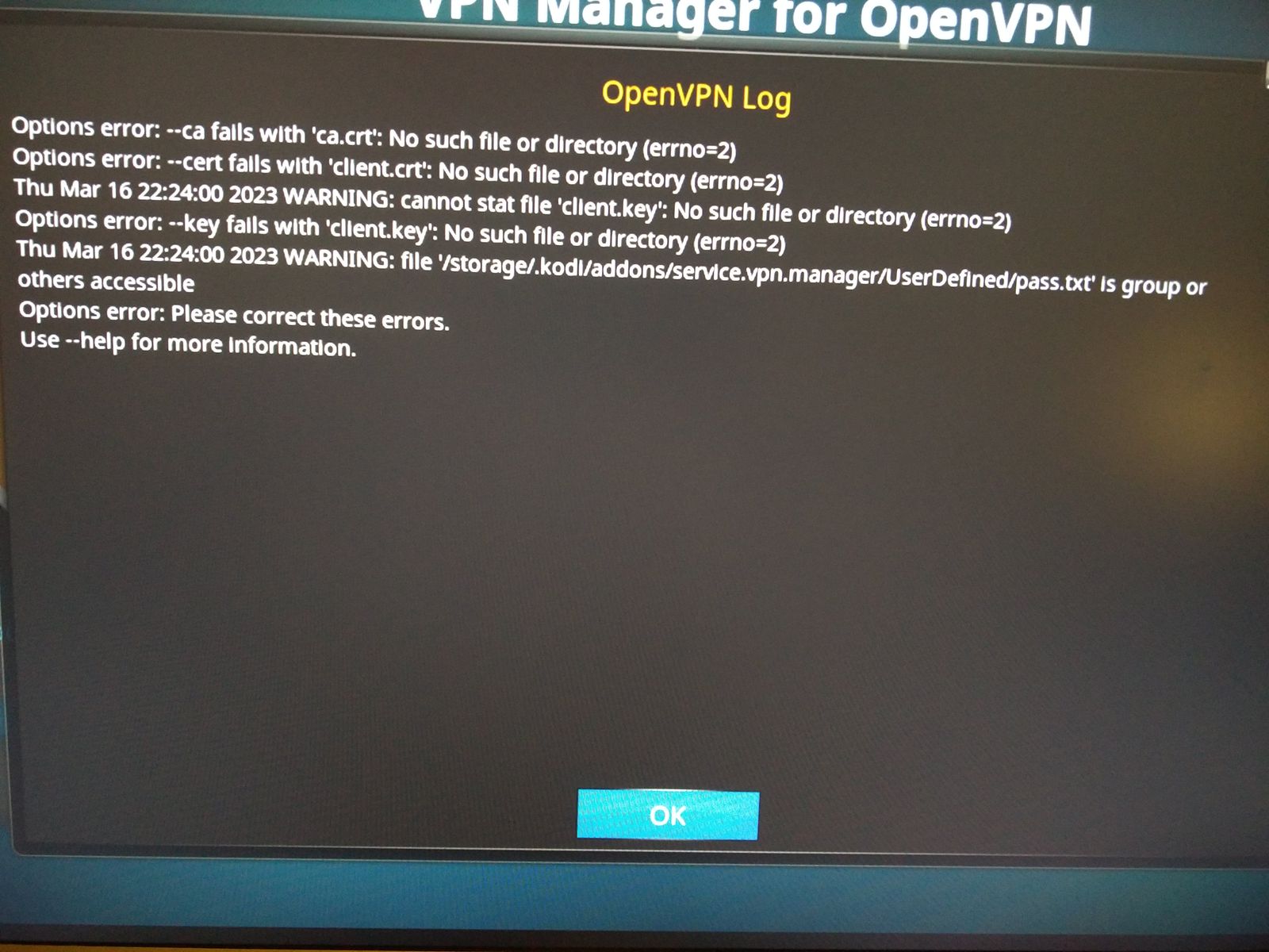

  • I am trying to connect to an openVPN server using cyber ghost. It works on my desktop but not on my raspberry pi with kodi. I've moved the crt and key files where they should be. I install the connection using the wizard on kodi... But it doesn't work. It worked in the past and I'm sure the VPN works on other devices. I'm getting this error in the log

  • The pass file probably needs "chmod 600" perms to skip that warning (but it's only a warning not an error). The other errors are fatal and it clearly doesn't see the files or there's something like a space in the filename or path.
  • Either the configuration expects files to be in a standard location and you've put them somewhere else, or you configure the location in the add-on (which I don't use or have any experience with) but some kind of unhandled issue with paths or formatting or permissions prevents the files from being read. As generic advice; don't use paths with spaces, ensure the text files have unix line endings (not Windows) and ensure the certs have 600 perms not 644/755/777.
