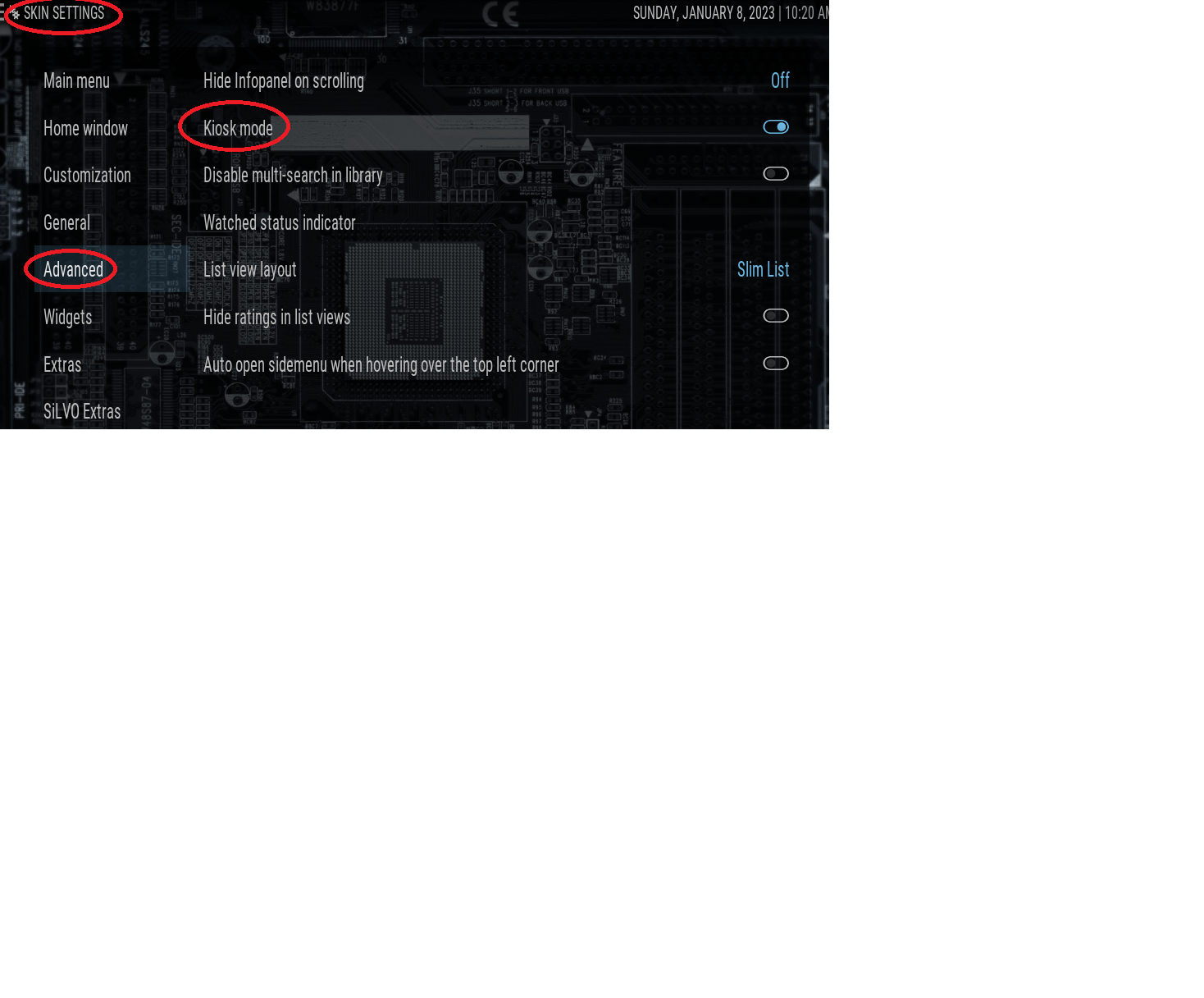

  • It sounds to me like you've accidentally set your view options to watched or unwatched videos.
    When you're scrolling through your movie list, you can arrow left to show the view options slide-out menu. Right above the "Action" heading, it normally shows "All Videos xx" (xx==the number of titles in your library). Changing that to "Unwatched" will display only titles you haven't watched. "Watched" displays titles you have watched. Change it back to "All Videos" to solve your problem.
    If you enable Kiosk mode, it will disable that slide-out menu. Looking around the Estuary settings, I'm not able to find Kiosk Mode. I normally use the Aeon Nox:Silvo skin where Kiosk mode is under Skin Settings - Advanced.
    I'll show a screen clip from Estuary. Other skins will display this differently.
    Here is Kiosk Mode under skin: Aeon Nox:Silvo
