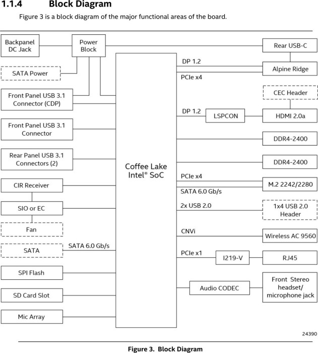

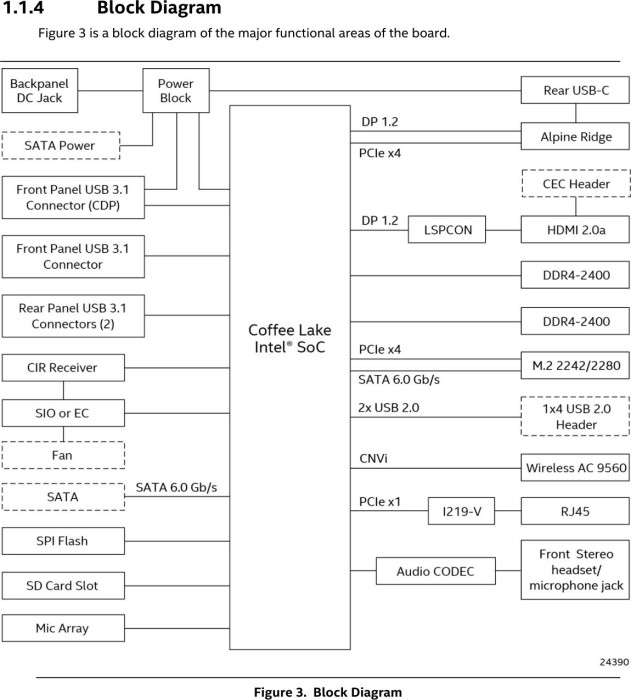

    AFAIK here is converter (LSPCON) DP => HDMI involved (picture attached)
    I guess this could be the case for the Gigabyte Brix 8250u too (don't know)

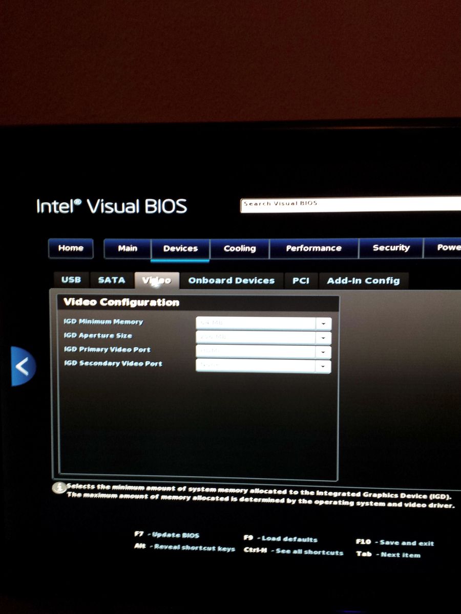

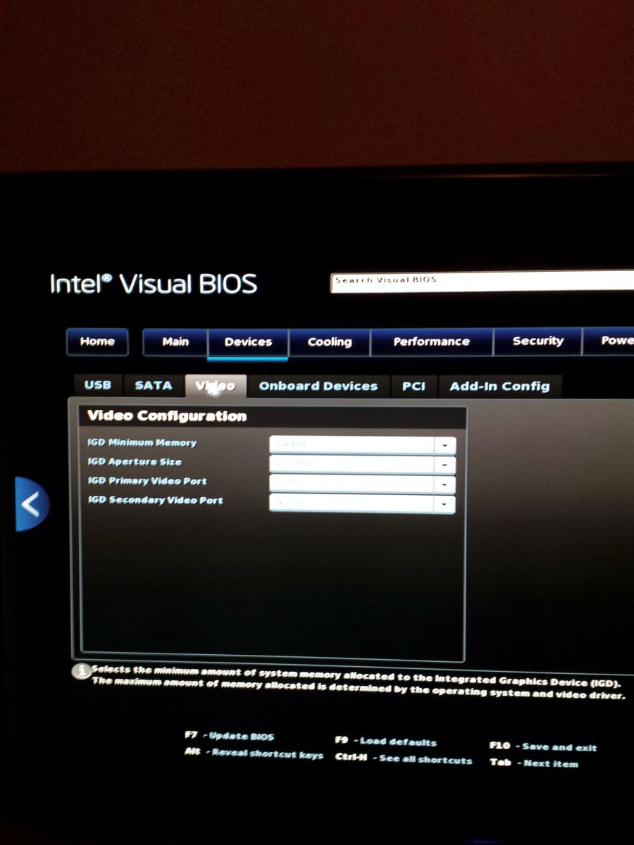

  • OK, then I think DP-1 is the "Mini DiplayPort", and DP-2 is the "HDMI 2.0" port. Can you check EFI / BIOS settings anyway? Maybe you can switch among HDMI and DVI mode for DP-2.
    Annoyingly there's very few configurable options in the BIOS, nothing for HDMI/Displayport etc.
  • Thanks for all of the help, really appreciated.
    Gigabyte have done a great job at neutering the available options, there's nothing that allows you to configure the HDMI/DP ports.
    I'll take some pics first thing tomorrow.
    Thanks again.
