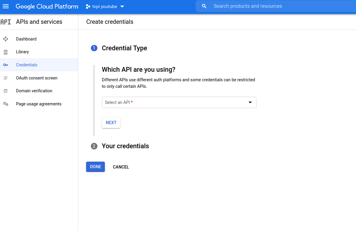

Could I get some help logging in to Youtube addon please?
  • I see there are buffering issues, but I can't get that far.
    I have never done this before.

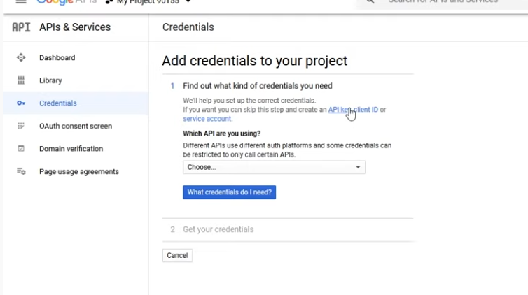

    I went to the website that the addon tells me to and watch the video.
    But at 0.57, the video alters from what i can see on my screen.
    They click on 'API key'.
    I don't have that.
    Thanks.
  • Google limits the number of searches per API key so the default key in the add-on is exhausted quickly. The workaround for this is creating your own 'app' as a Google developer and then configuring/using your own API key (with your own limits). This is probably what the YouTube video is instructing you on.

    The add on on librelec tells me to go to a link and follow the instructions.
    Takes me then to this video:
    External Content www.youtube.com
    At 57 seconds it tells me to click on a link 'API key'.
    I don't have that link.
    At that point, I don't know what to do.
    I wondered if there might be a new set of instructions or something.
    Cheers.
  • There may be new instructions for generating your own API Keys. Post your questions on Kodi's addon forum here: Kodi's YouTube Addon Support Thread

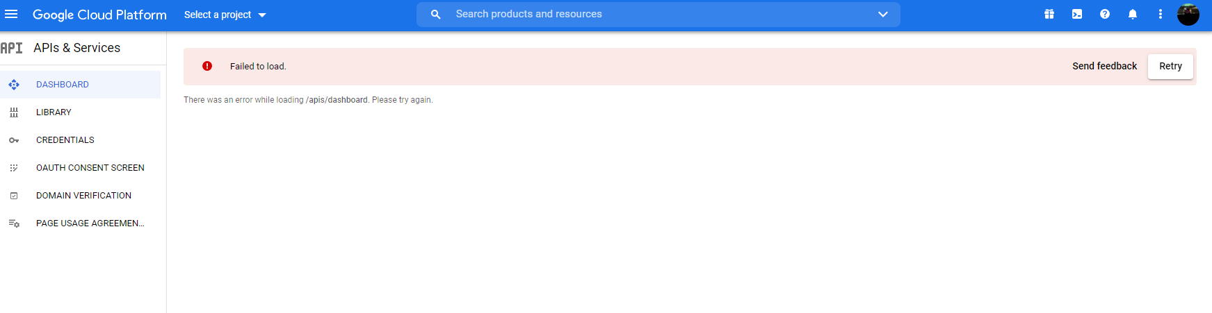

    I don't use YT much on the Libreelec box but just occasionally I'd like to. It's always worked just fine but after the last update (on 9.2.6 now) it asks to sign-in. I followed the instructions on the link provided and it takes me to this page -
    https://github.com/anxdpanic/plug…rsonal-API-Keys
    I'm signed-in on that page but it refuses to let me create a project or whatever it is I'm supposed to do. See the attachment.
    After reading this thread I thought I'd try to update to V10 but I can't long-in with SSH as it doesn't recognise any password I've tried. (kodi, libreelec, password, guest, admin) I would not have changed the password so I don't know how to go any further with that either.
    Any suggestions please? If it's going to be a s**tfight I'll just delete the YT app from the box and be done with it.
