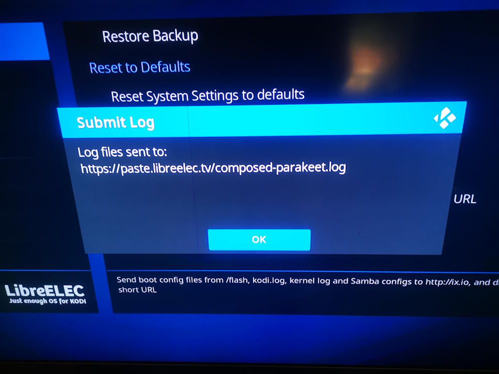

I got the log file though, hopefully there's something there that might help. -

Sorry about that, try this one then.
http://ix.io/4IEl -

http://ix.io/4IDX -

Is this all that you're after?
