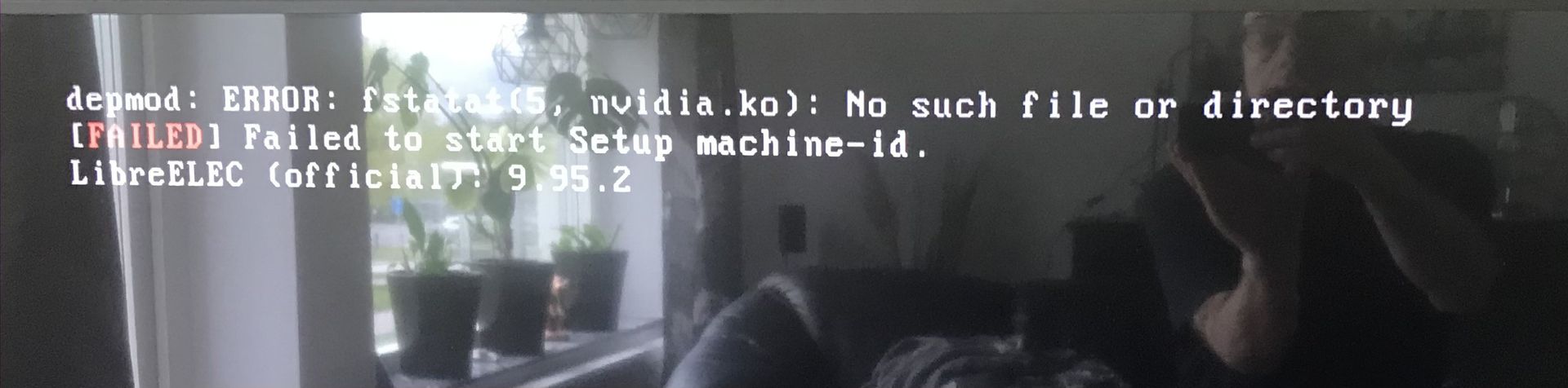

    I gotten an error code yesterday when resetting my installation and i want to know what's wrong?
    Is my old device no longer supported?
    My chipset is : Intel NM10
    Processor model: Intel Atom D525
    Graphics processor: Nvidia ION 2
    Non of these is to be found among the list of forum to post in. :)
    Please help me.
    The error could be seen at the attched picture here:
    • Official Post
    First install the latest LE 10 Beta (don't upgrade, as mentioned in the release notes). Maybe that already fixes your bug.
    If you still get an error with the latest Beta, write a bug report. Write a complete report, as demanded at the pinned post on top.
  • First install the latest LE 10 Beta (don't upgrade, as mentioned in the release notes). Maybe that already fixes your bug.
    Hi and thanks, i couln't wait so i made a fresh new install and have now my system up and running without any errors. :)

    I had the Matrix version 19.0 installed and it worked. But i couldn't get the SMB to work so i did a reset and then i got my errors at the startup.
    There's no known problem or so with the latest LibreElec?! If not i'll give it a try.
  • The latest - the greatest! In case you're using encrypted Widevine streaming content, you have to update this month.
    With a good backup strategy it's just go, go, go. :P
    I gave it a good night of sleep and was thinking that my startup error occurred when i used the reset option in LibreElec settings to restore default settings. After this a folder was missing for nvidia. That makes me wonder if something is wrong with the latest version.... it was ok until i made a restore.
