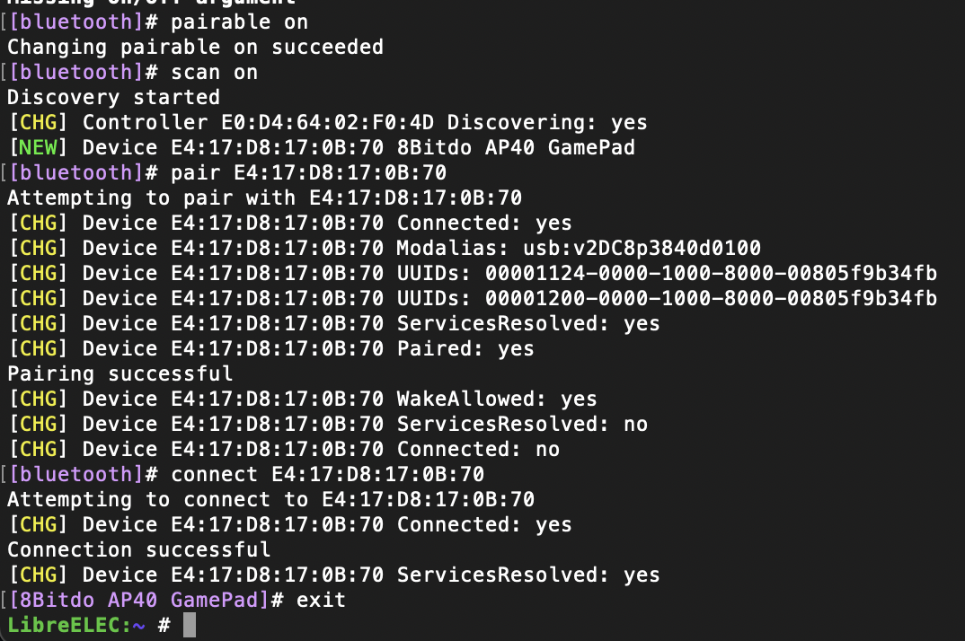

    did anyone get 8BitDo Gamepads to work with x86 natively (without dongle) in LibreELEC(-RR)?
    I have a ASrock J5005 and tested two intel M.2 cards without success. I get them paired only via bluetoothctl but they lose the connection quite immediately.
    They work flawlessly on RPi4 and LibreELEC 10.
    Does anyone have an idea?
    Thanks

  • I have ordered an intel 7260 mpcie card for my x86 build on Monday, it camed today finally.
    And i have readed the other post of your issue.
    Let me say this, while Bluetooth was on linux always a bit of a pain, doesn't matter which distribution. I got it always working.
    With today's testings, with the 7260 card, i have same issues as on the pi4. And this issue is bigger and related to Bluetooth kernel modules or Bluetoothctl or hci.
    To be more precise, the pairing process looks broken, scanning works, but pairing not.
    It says it paired, it connects and disconnects in a loop, but i can't get anything properly paired and connected.
    No matter if on the rpi4 or 7260.
    First i thinked it is probably xpadneo, but it isn't, the module isn't even loaded, even a recompile without it doesn't works.
    On Ubuntu 20.04, Bluetooth is a pain, but after many tryes of pairing/connecting it works. And once you connected it once it works constantly perfect (that one device)
    On libreelec, doesn't matter if RR or not RR it doesn't work, i tryed it almost 100 times.
    Replacing the firmware for the 7260 (bluetooth module) leads nowwhere, since hci says that it's already patched to v57 and doesn't even try to load the "ibt-hw-..." files.
    And there is no documented way or command to load the firmware yourself.
    But those bluetooth firmware files or patchfiles, are for all intel Bluetooth devices, it doesn't matter if it's an ax200 or an super old 7260/7265 module. All the same fw files. That means if bt isn't working on one intel module, the possibility is extremely high that it won't work on all other intel cards too.
    Only the wifi firmware is for every module different.
    So it's a pain, the whole Bluetooth code is crappy on linux anyway if you ask me. Even on macos and windows it's not always perfect.
    The only thing where Bluetooth is a no brainer, is on the phones.
    However, I don't give up yet.
    Cheers.

    Meanwhile I believe that the board has issues. I remember, that the Asus board before was working and could find Wifis and BT devices. View minutes ago I tried the Qualcomm out of this board once again in the ASrock and it has the exact same issues as the intel cards. But what makes me wondering most, is, that the pairing and function with RPi works flawlessly. I had RetroPi on the RPi 3b+ and LE10 on the Pi4. Every single time I tried to pair the 8BitDo's it was successful and I could configure&use them properly. Only the J5005 has issues.
