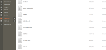

I want to run LibreELEC-AMLGX.arm-9.80.7-box.img.gz via sdcard/usb on a minix neo u1.
Is this possible?
Tried everything but it doesnt boot.
Tried: meson-gxbb-p200.dtb & meson-gxbb-p201.dtb renamed to dtb.img in root dir.
Is this possible?

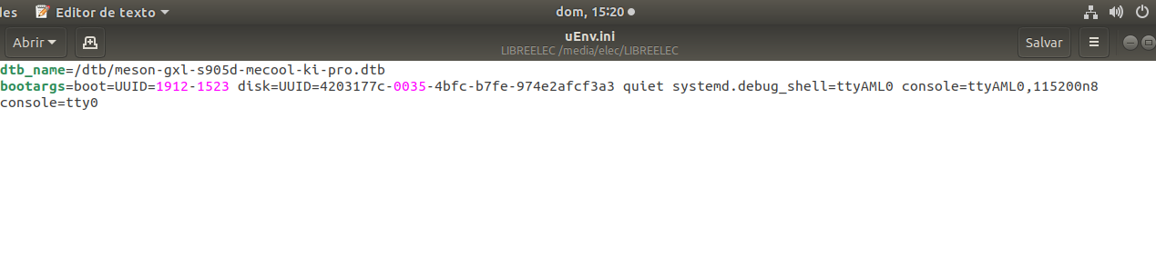

This method of renaming dtb no longer works in LibreELEC, in the new project.
In the text file uEnv.ini edit the text leaving it like this.
With the dtb of your choice as in red! meson-gxl-s905d-mecool-ki-pro.dtb
You only need to edit the first line from the meson with your dtb, as in the model below.
This is just a model of my box.
Thx a lot.
Now it starts

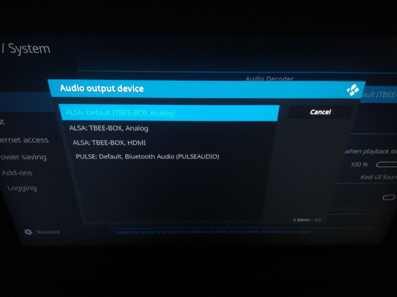

Images from ~ 5 mins ago have much improved audio on G12A, G12B and SM1 devices. You should be able to play all media without encountering static (all the multi-channel audio files I have work) and multi-channel audio channel mappings are fixed. I have disabled IEC958 devices in the alsa conf as I get static pops that don't sound tweeter friendly when trying to use the "HDMI" device or pass-through; the drivers are not ready for this yet. Select the "Analogue" card listed immediately above pulseaudio.
The same changes are in the GX device images, but I haven't done any testing to see if the revised alsa conf has a positive effect on the "machine gun noise" (buffer underrun) problem in the AIU driver.
tavoc The "box" image is for booting devices with vendor u-boot, the "khadas-vim" image has mainlne u-boot and is for writing LE to internal emmc (overwriting the vendor u-boot).
In limited testing the revised alsa conf appears to prevent machine gun noise on GX boards. It's a workaround not a fix, but until somene figures out where the buffer underrun is occurring it will save some speakers (MGN is nasty). I'm currently hoping that LibreComputer will fund further work on multi-channel audio in the coming months, but this is still to be confirmed. Martin B is also poking around in the AIU driver to add support to Meson8 hardware, which may also help.
