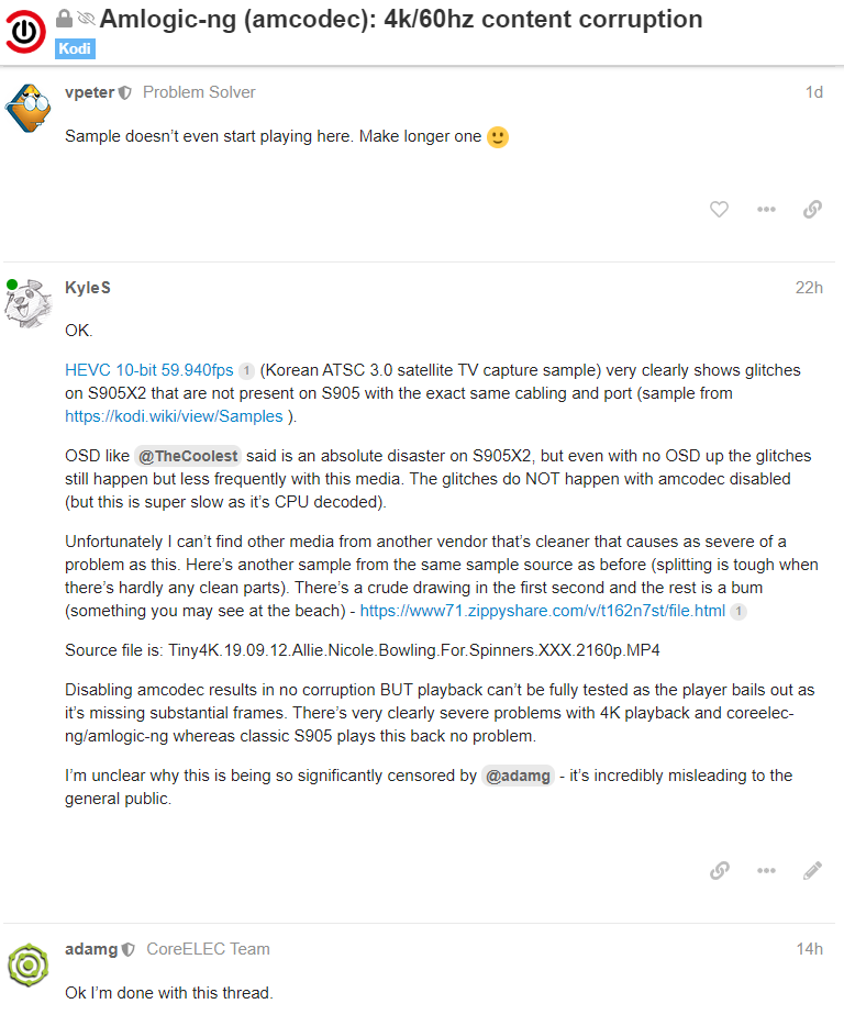

Does anyone have the latest on h.265 support for this? CoreElec still cannot play simple 4k60hz video and has completely corrupt output (dusted off my "new" box from February and these basic same issues are present) so I'm totally looking to flip again.
I also had eMMC corruption the last time I tried the LE image (from Bables) - has this been resolved?

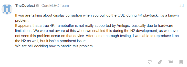

The reason I made the thread was to bring awareness to the issue and to help resolve as I'm aware team members don't necessarily have 4K panels to truly test. The information being purposely hidden (see how adam unlisted the thread) is incredibly problematic and I know would have certainly stopped me and many others from buying a box.
LibreELEC (OSS Linux really) currently can't do 4K content as the decoder isn't upstream and/or written yet. This is why I made the thread here to ask if it's actually fundamentally a hardware problem - or if it's a simple amlogic SDK problem.
I'm incredibly unclear why CoreELEC is censoring this information... Any 4K content on the SoC is nearly completely corrupt when it's hardware accelerated. I suppose it's because they received sponsorship money and are peddling bad units now?
Will LibreELEC have this problem too with accelerated content?
https://discourse.coreelec.org/t/amlogic-ng-a…corruption/7039
