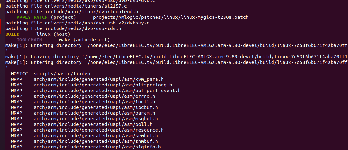

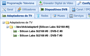

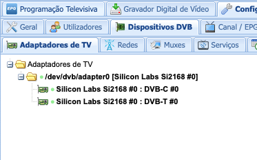

smp It's working, thanks to your support!
The Search, has some frequencies that are giving error, but there may be the cable.

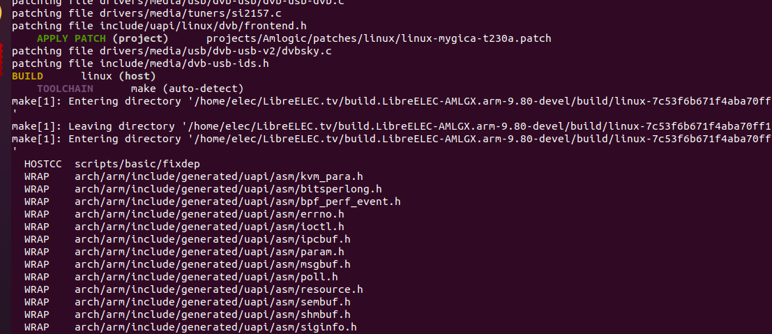

Looks like the file got corrupted somehow.
Try this one.
The other times only one line entered:
patching file include/media/dvb-usb-ids.h
Now it was different, there were two
Oops! Now you recognized it, at first! The Search is still testing, some frequencies I had to redo a few times to find the channels.

I realized that different from the tbs5520se The same was needed:
Add CONFIG_DVB_USB_TBS5520SE=m to projects/Amlogic/linux/linux.aarch64.conf
It will look like this:
CONFIG_DVB_USB_TECHNISAT_USB2=m
CONFIG_DVB_USB_V2=m
The tuner was not recognized in TVH.

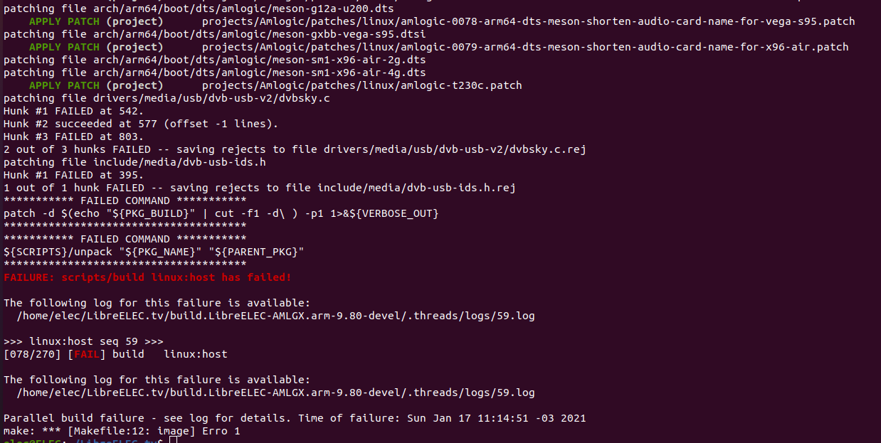

Do I come to ask for your help? can you please tell where the error is?
smp important: How to add new MyGica T230A? · Issue #224 · tbsdtv/linux_media · GitHub
patches: 8ec77749b81a70c8616e39be4a0e2e0a5a9eb165.patch
I know you will certainly have a direction, I tried to include this patch in the construction of the chewitt and I get errors related to: drivers / media / usb / dvb-usb-v2 / dvbsky.c
include / media / dvb-usb-ids.h
I just edited the patch for amlogic-t230c.patch.
I directed to: projects / Amlogic / linux / patches.
