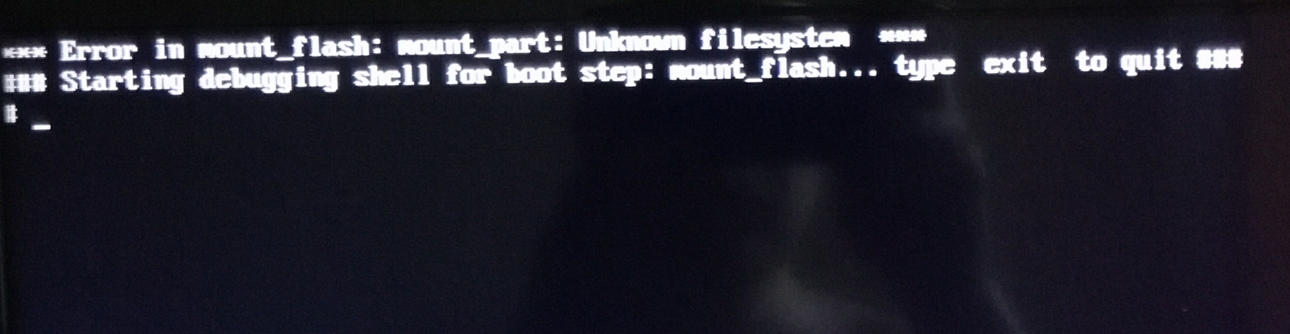

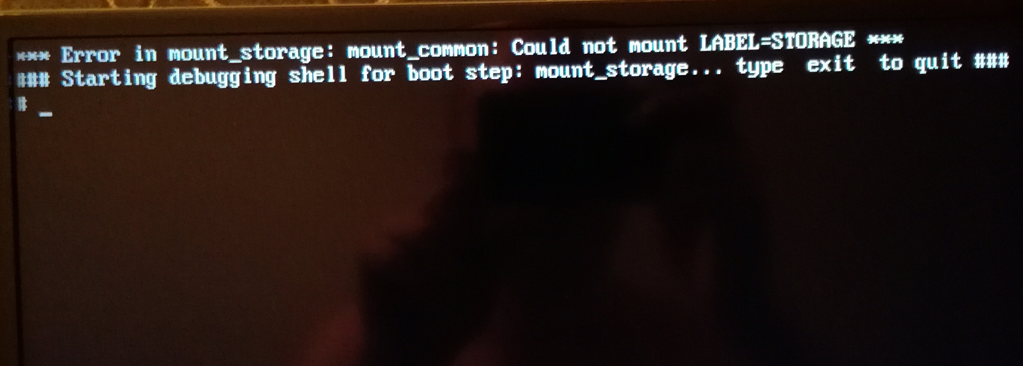

    As for the Eny M8S (n200's) for some reason Datrh's seems not to make a actual working img... It works great on all the minix devices but the older Eny's for some reason always ends up with a corrupted file system or can't find the proper partition. The compile goes ok and it produces a img but the image always comes up with the filesystem corrupt message or it can't find the partition its looking so it never expands the system on install. The wierd part is that happens when using a linux box to create the sdcard yet if you use windows and libreelecs sdcreator to create the sdcard it will get past the above mentioned errors and do the install but then it runs really unstable...
    I gave up trying to find the issue with datrh's repo on these old n200 based boxes and made some mods to his build setup and made it work and have been testing it for awhile and it seems fine.
    I just finished updating it to Leia 18.7.2 and once i am done a bit of testing if you want a copy to try, let me know and i will upload it someplace... Its intended for the original Eny M8S using the n200_2g device tree...

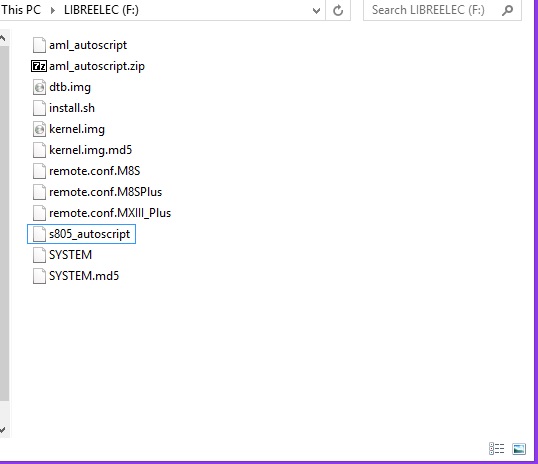

    Did you rename the dtb file to dtb.img and copied it to the root of sdcard first partition? If you just copyed the file into device_tree it is not enough.

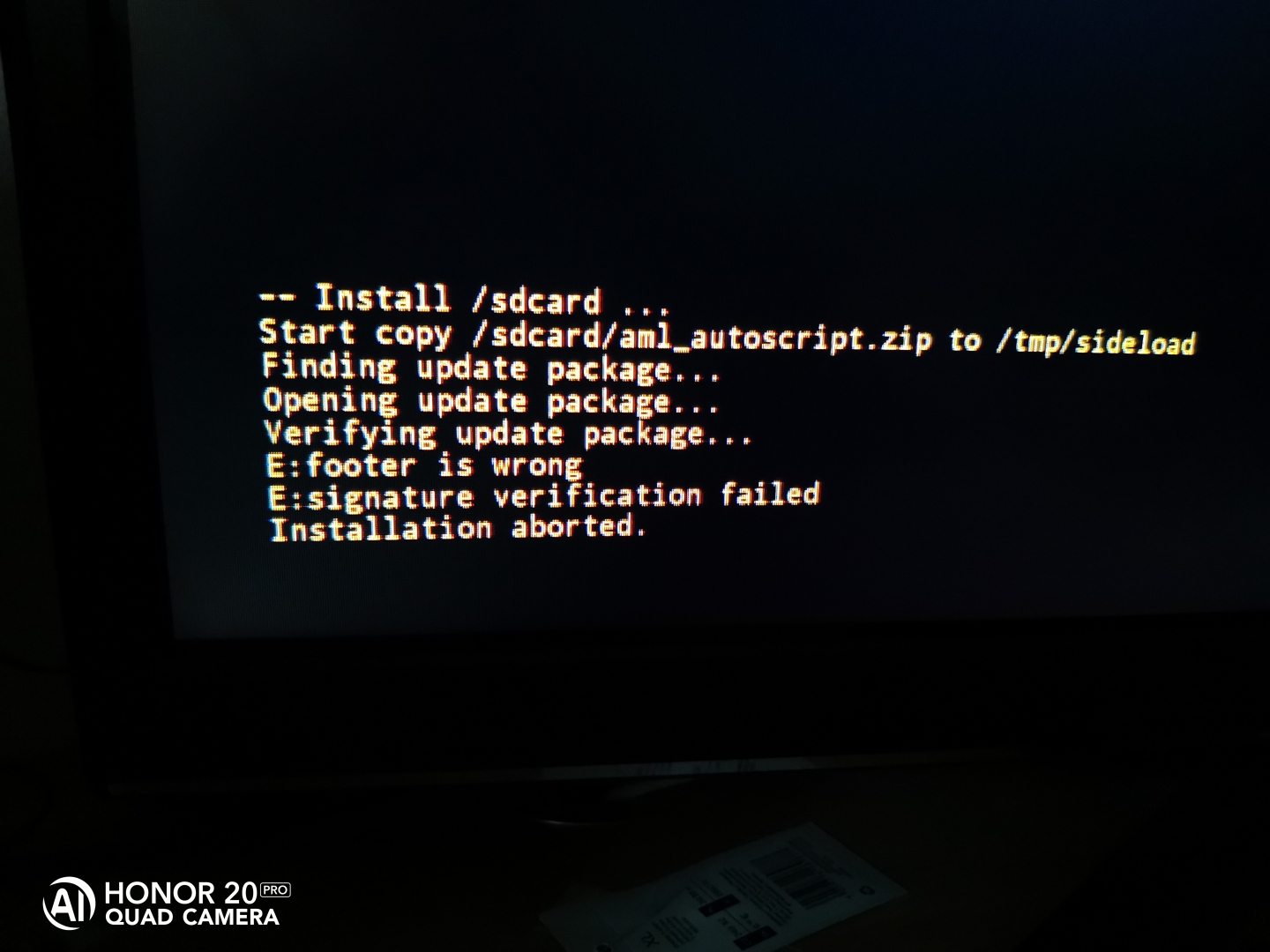

  • Trying to put LibreELEC-X8-H_Plus.arm-LE9-Kodi_18.6 onto a X8H-Plus. Image written okay, renamed boot.scr.
    When booting I get to recovery with "Cannot load volume /misc!" at the bottom - but looking at the .img contents I don't see this...
    I actually see I posted back in Jan about this, and one suggestion was to unplug the remote which I did with no luck.
    when you boot with the reset switch pressed, it will not go to the Android recovery process.
    In fact you won't notice anything except that your box will boot "LibreElec" in place of Android.
    i guess there's something wrong with the method you follow.
    Be sure to burn the image with the LibreElec usb SD creator, press the reset switch a few seconds and release it.
