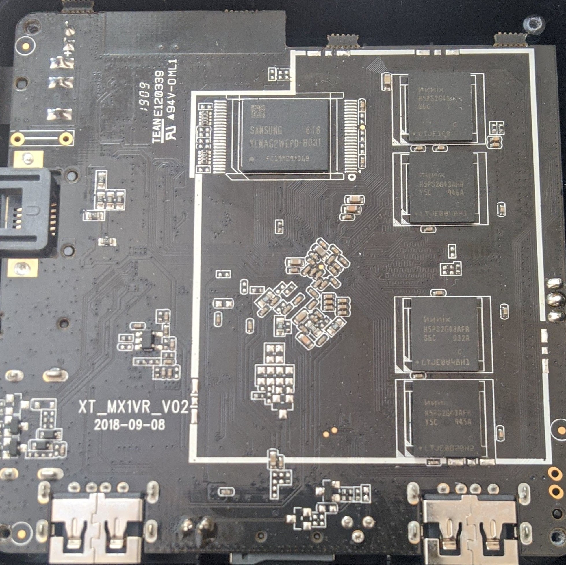

  • @DS1
    this is a well known board, shishion or andowl brand !
    it is a REAL 3229 but with ddr2 and emmc storage
    so ANY of images on the first post with this characteristic will surely boot !
