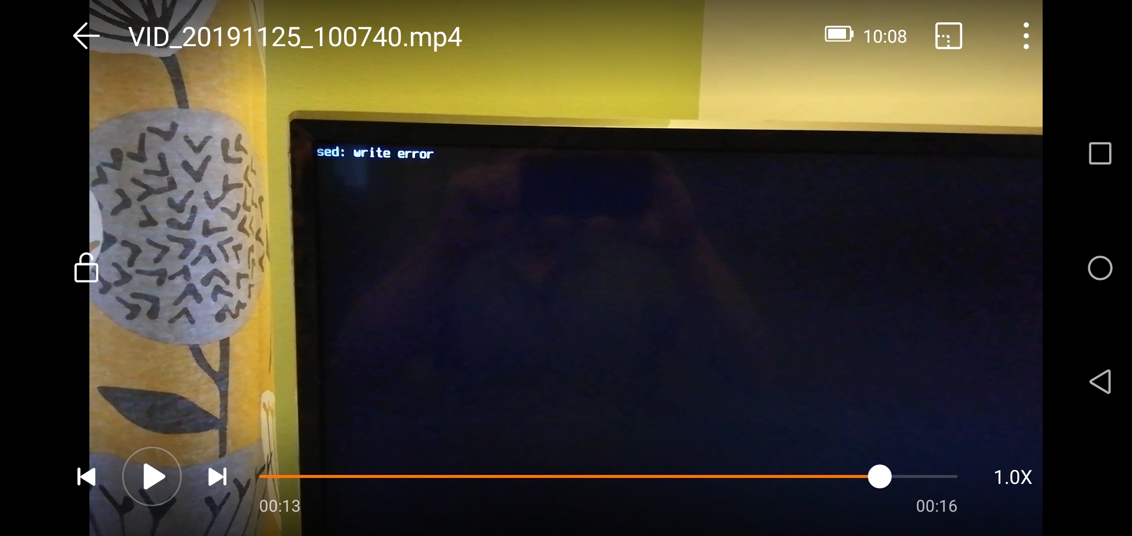

  • It comes up just before the "libreelec (official) 9.1.502" text appears in the top left corner of my screen.
    It's only there for a second or 2 so hard to get a picture lol.
    The image still works but just want to know if this error is safe to ignore.

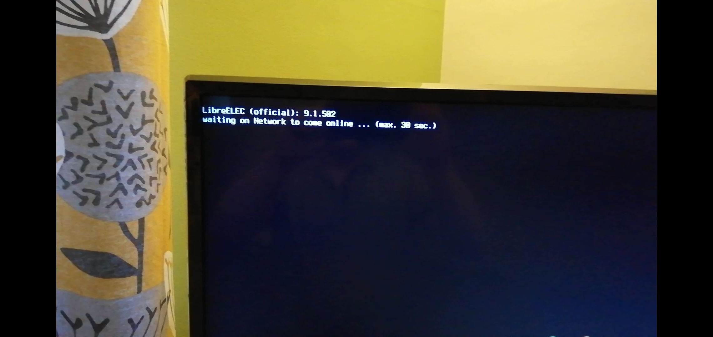

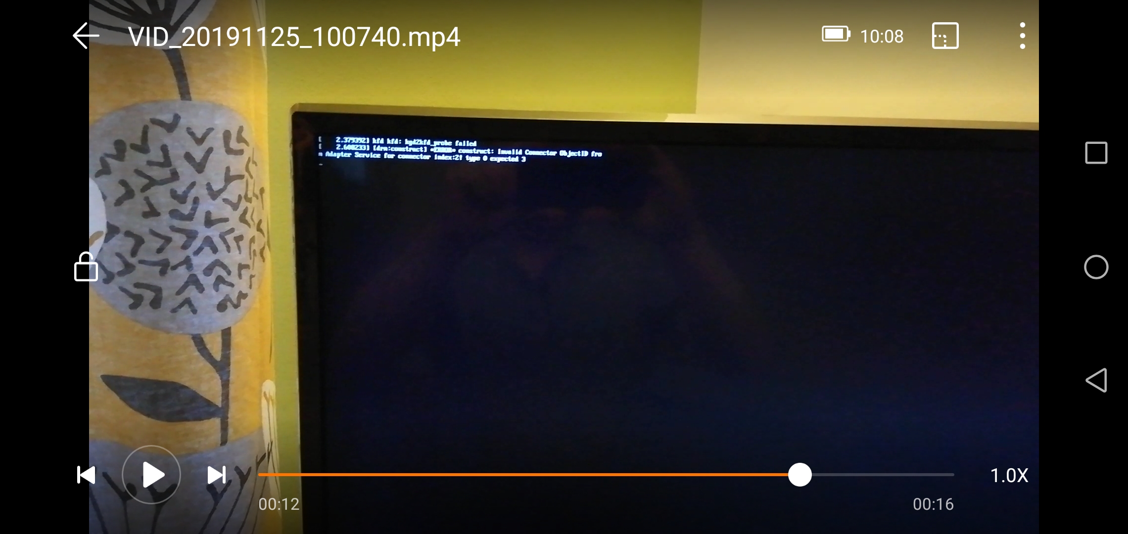

  • I've recorder the errors using my phone then took screen shots.
    These are in order of the warnings that pop up.
    Thanks

    Sounds OK to me. In relation to your first screenshot ("Invalid Connector...") it could be a Bluetooth bug on LE 9.1.502.
    You can try with disabled Bluetooth to check my theory.
    It's probably not the right time to go into this issue too much, because I expect the LE release 9.1.503 or 9.2 every moment.
