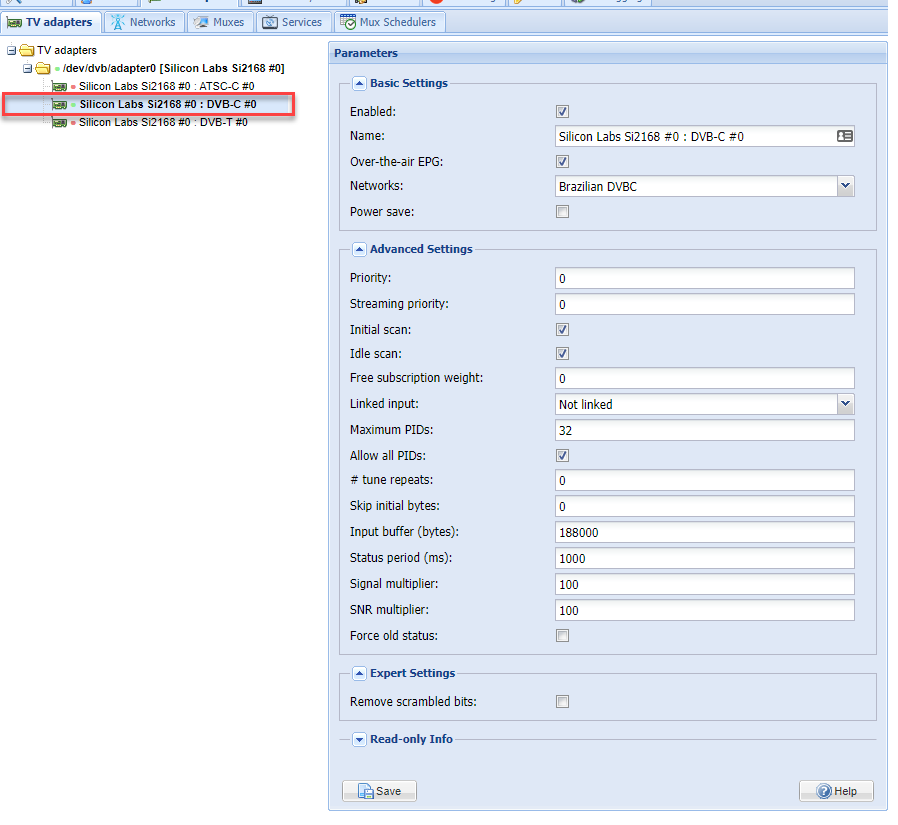

  • Hi all,
    I bought two T230C DVB-C MyGica adapters and i can't make it work.
    I was trying 2 different OS ( Coreelec and Libreelec).
    Tvheadend recognizes the adapter on both when I'm using crazycat driver, everything looks ok.

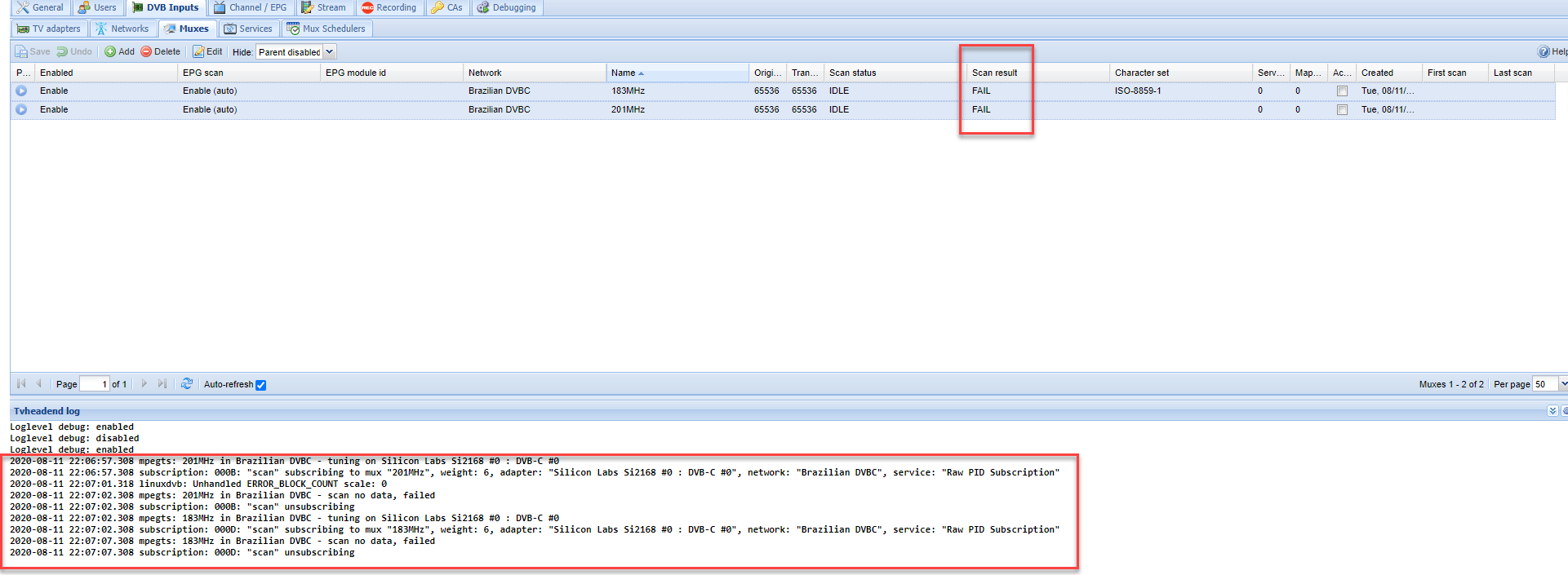

    when I'm trying to scan I'm getting: failed.
    TVHEADEND

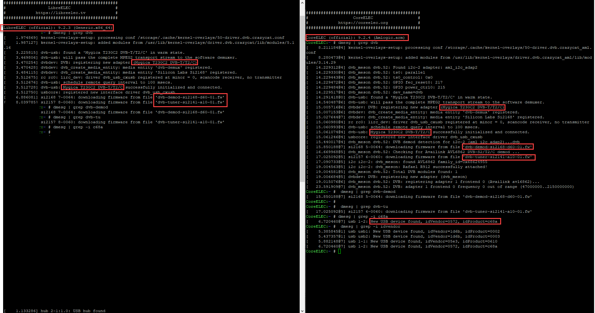

    Resume dmesg
    dvb-usb: found a 'Mygica T230C2 DVB-T/T2/C' in warm state.
    si2168 5-0064: downloading firmware from file 'dvb-demod-si2168-d60-01.fw'
    si2157 6-0060: downloading firmware from file 'dvb-tuner-si2141-a10-01.fw'
    usb 1-2: New USB device found, idVendor=0572, idProduct=c68a
    COREELEC OS
    LIBREELEC OS X86 (Intel i5)
