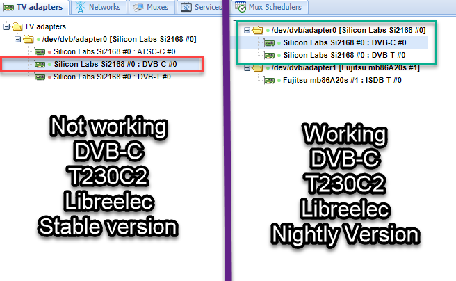

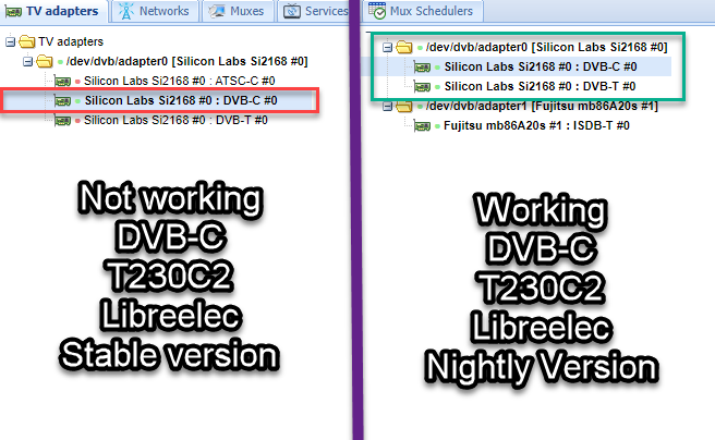

    You are the best CvH! I tried today and it works!
    I have to say that I tried a clean installation using LibreELEC-Generic.x86_64-9.80-nightly-20200812-6063236.img.gz but it doesnt works. I flash using a corsair flash drive but it doesnt boot. Say "error in mount flash libreelec". I tried using usb 2.0 and 3.0 port.
    So what a did were to update using .tar version. (I place it on update folder and reboot)
    I tried to install tvheadend 4.3 but I received an error message about compatibility.
    Do you know how to install?
    I tried this: Generic-service.tvheadend42-4.3-1896.zip
    For your Intel HTPC I would try to update to some nightly build an see if there is a improvement (or boot from usb or soemthing), try to use it without any additional driver. test.libreelec.tv
    It looks like the device is actually properly supported at the vanilla kernel.
    Do a backup before because otherwise you can't downgrade without problems.
    it sounds hopeful! I will try it! = )
    Let me ask you, how is the process to update libreelec on x86 intel?
    Which file I have to use? And how to use?
    LibreELEC-Generic.x86_64-9.80-nightly-20200812-6063236.ova
    LibreELEC-Generic.x86_64-9.80-nightly-20200812-6063236.tar

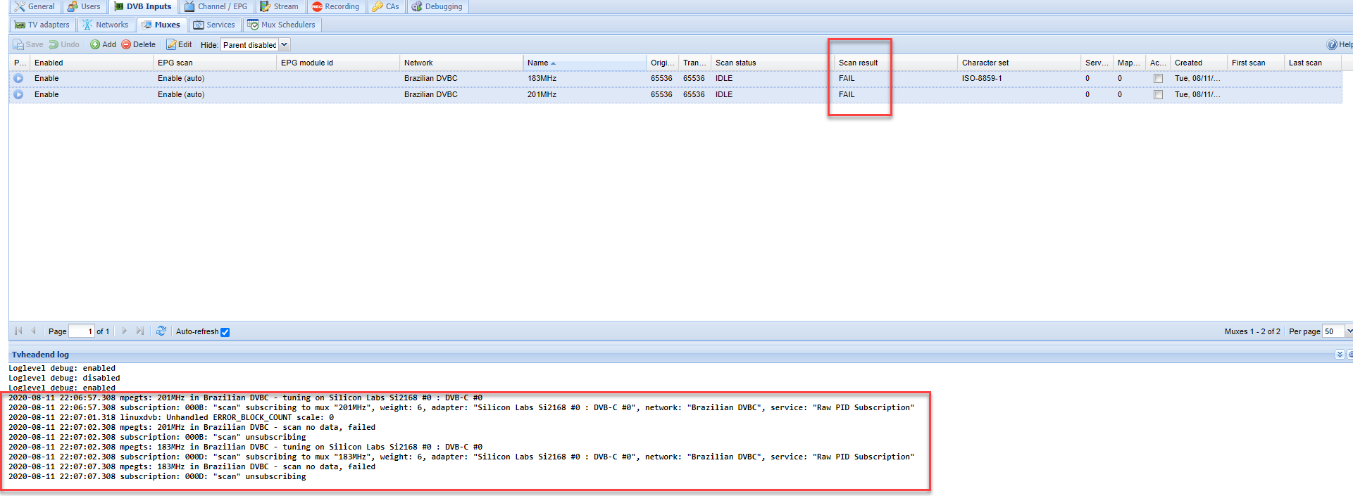

    Hi all,
    I bought two T230C DVB-C MyGica adapters and i can't make it work.
    I was trying 2 different OS ( Coreelec and Libreelec).
    Tvheadend recognizes the adapter on both when I'm using crazycat driver, everything looks ok.
    when I'm trying to scan I'm getting: failed.
    TVHEADEND
    2020-08-11 22:06:57.308 mpegts: 201MHz in Brazilian DVBC - tuning on Silicon Labs Si2168 0 : DVB-C 0
    2020-08-11 22:06:57.308 subscription: 000B: scan subscribing to mux 201MHz, weght: 6, adapter: Silicon Labs Si2168 0 : DVB-C 0, network: Brazilian DVBC, service: Raw PID Subscription
    2020-08-11 22:07:01.318 linuxdvb: Unhandled ERROR_BLOCK_COUNT scale: 0
    2020-08-11 22:07:02.308 mpegts: 201MHz in Brazilian DVBC - scan no data, failed
    2020-08-11 22:07:02.308 subscription: 000B: scan unsubscribing
    2020-08-11 22:07:02.308 mpegts: 183MHz in Brazilian DVBC - tuning on Silicon Labs Si2168 0 : DVB-C 0
    2020-08-11 22:07:02.308 subscription: 000D: scan subscribing to mux 183MHz, weght: 6, adapter: Silicon Labs Si2168 0 : DVB-C 0, network: Brazilian DVBC, service: Raw PID Subscription
    2020-08-11 22:07:07.308 mpegts: 183MHz in Brazilian DVBC - scan no data, failed
    2020-08-11 22:07:07.308 subscription: 000D: scan unsubscribing

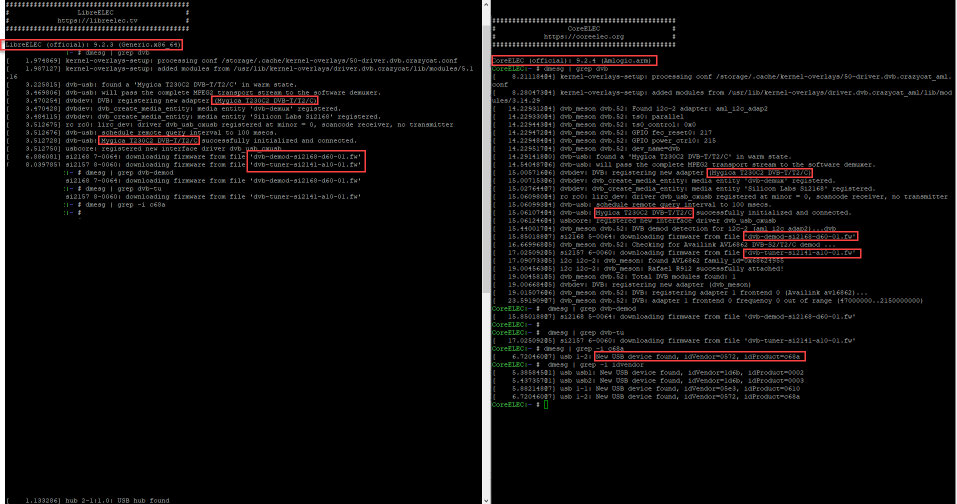

    Resume dmesg
    dvb-usb: found a 'Mygica T230C2 DVB-T/T2/C' in warm state.
    si2168 5-0064: downloading firmware from file 'dvb-demod-si2168-d60-01.fw'
    si2157 6-0060: downloading firmware from file 'dvb-tuner-si2141-a10-01.fw'
    usb 1-2: New USB device found, idVendor=0572, idProduct=c68a
    COREELEC OS
    LIBREELEC OS X86 (Intel i5)
    Display Spoiler
    # LibreELEC #
    # LibreELEC – Just enough OS for KODI #
    LibreELEC (official): 9.2.3 (Generic.x86_64)
    :~ # dmesg | grep dvb
    [ 1.974869] kernel-overlays-setup: processing conf /storage/.cache/kernel-overlays/50-driver.dvb.crazycat.conf
    [ 1.987127] kernel-overlays-setup: added modules from /usr/lib/kernel-overlays/driver.dvb.crazycat/lib/modules/5.1 .16
    [ 3.225815] dvb-usb: found a 'Mygica T230C2 DVB-T/T2/C' in warm state.
    [ 3.469806] dvb-usb: will pass the complete MPEG2 transport stream to the software demuxer.
    [ 3.470254] dvbdev: DVB: registering new adapter (Mygica T230C2 DVB-T/T2/C)
    [ 3.470428] dvbdev: dvb_create_media_entity: media entity 'dvb-demux' registered.
    [ 3.484115] dvbdev: dvb_create_media_entity: media entity 'Silicon Labs Si2168' registered.
    [ 3.512675] rc rc0: lirc_dev: driver dvb_usb_cxusb registered at minor = 0, scancode receiver, no transmitter
    [ 3.512676] dvb-usb: schedule remote query interval to 100 msecs.
    [ 3.512728] dvb-usb: Mygica T230C2 DVB-T/T2/C successfully initialized and connected.
    [ 3.512750] usbcore: registered new interface driver dvb_usb_cxusb
    [ 6.886081] si2168 7-0064: downloading firmware from file 'dvb-demod-si2168-d60-01.fw'
    [ 8.039785] si2157 8-0060: downloading firmware from file 'dvb-tuner-si2141-a10-01.fw'
    :~ # dmesg | grep dvb-demod
    :~ # dmesg | grep dvb-tu
    :~ # dmesg | grep -i c68a

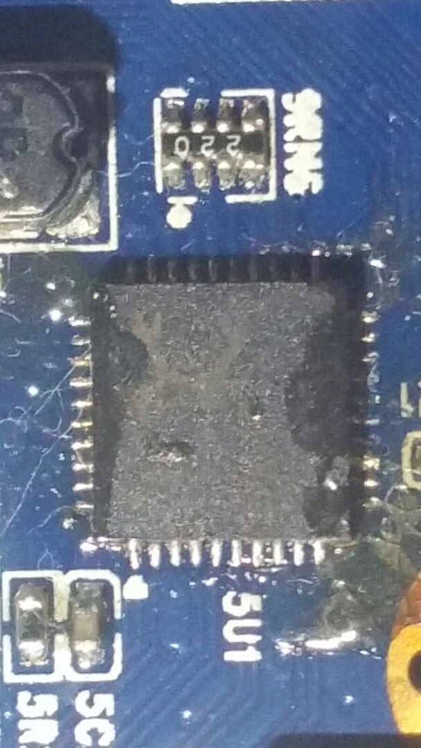

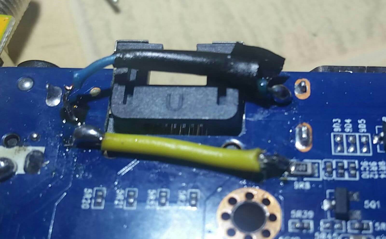

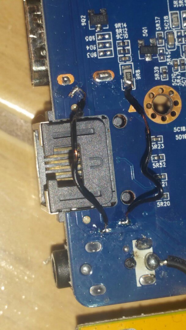

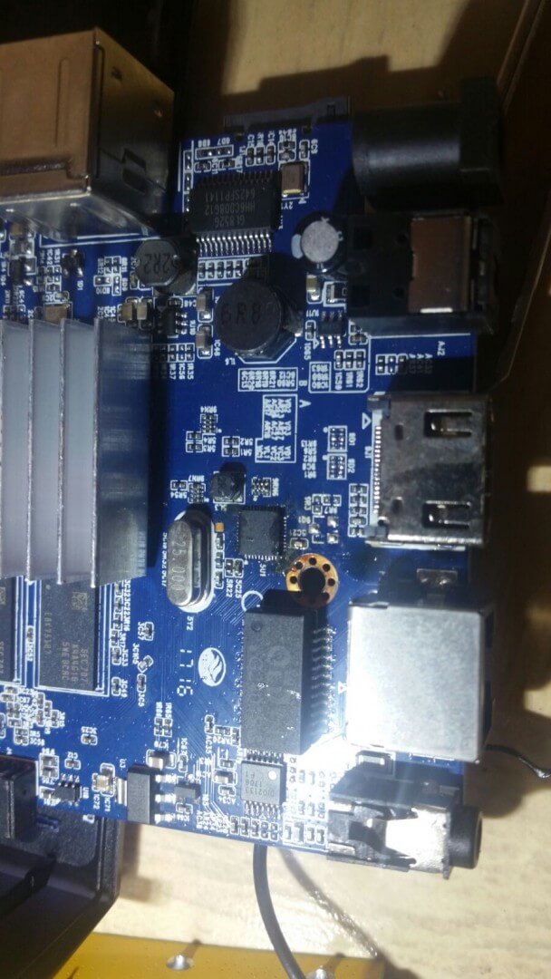

    This pic2, I have this specific problem since the first day that all my 3 KIII PRO arrived in my house. But it only happens when I watch DVB-C or DVB-S HD channels. It can be on Android DTV or TVheadEnd. Btw I have a KI pro and it is perfect. That's sad.
    I figured out why my ethernet wired stop to work. I'm going to send what I figured out!
    WARNING GRAPHIC IMAGE!!
    MELTED CABLE! (The wires were together and short-circuited, so pay attention on your boxes about)

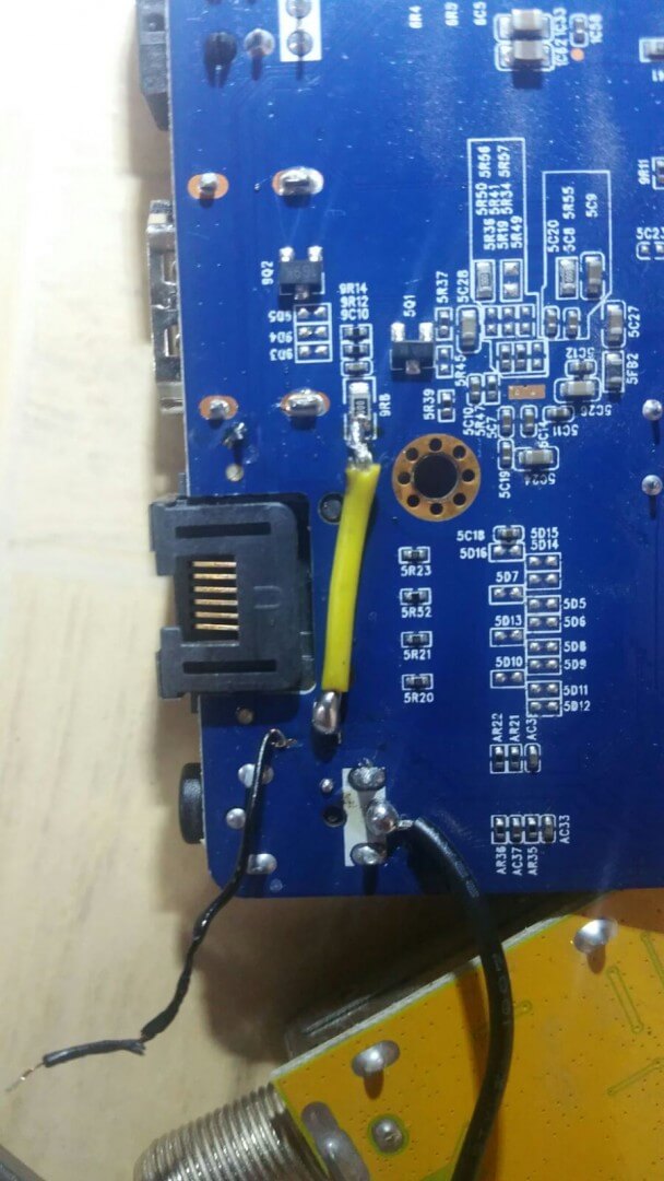

    So I try to fix:
    but I think that my ethernet module is partially melted.
    Now my ethernet is working some times.. (Realy, some time yes some times no!!) oh china box!
    Pelican, do you think that it is possible to change this module? Do you know which can I buy or how can I know that?
