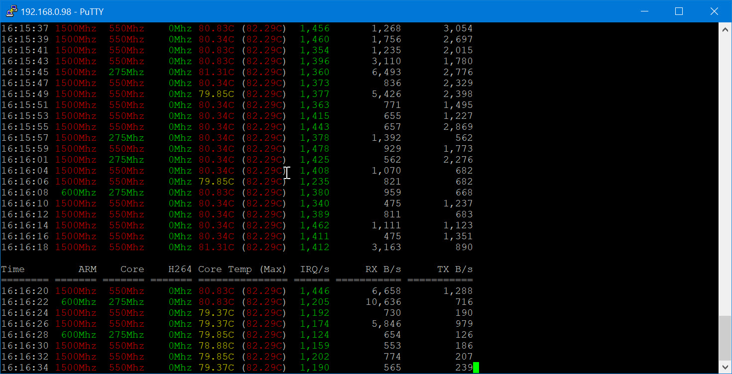

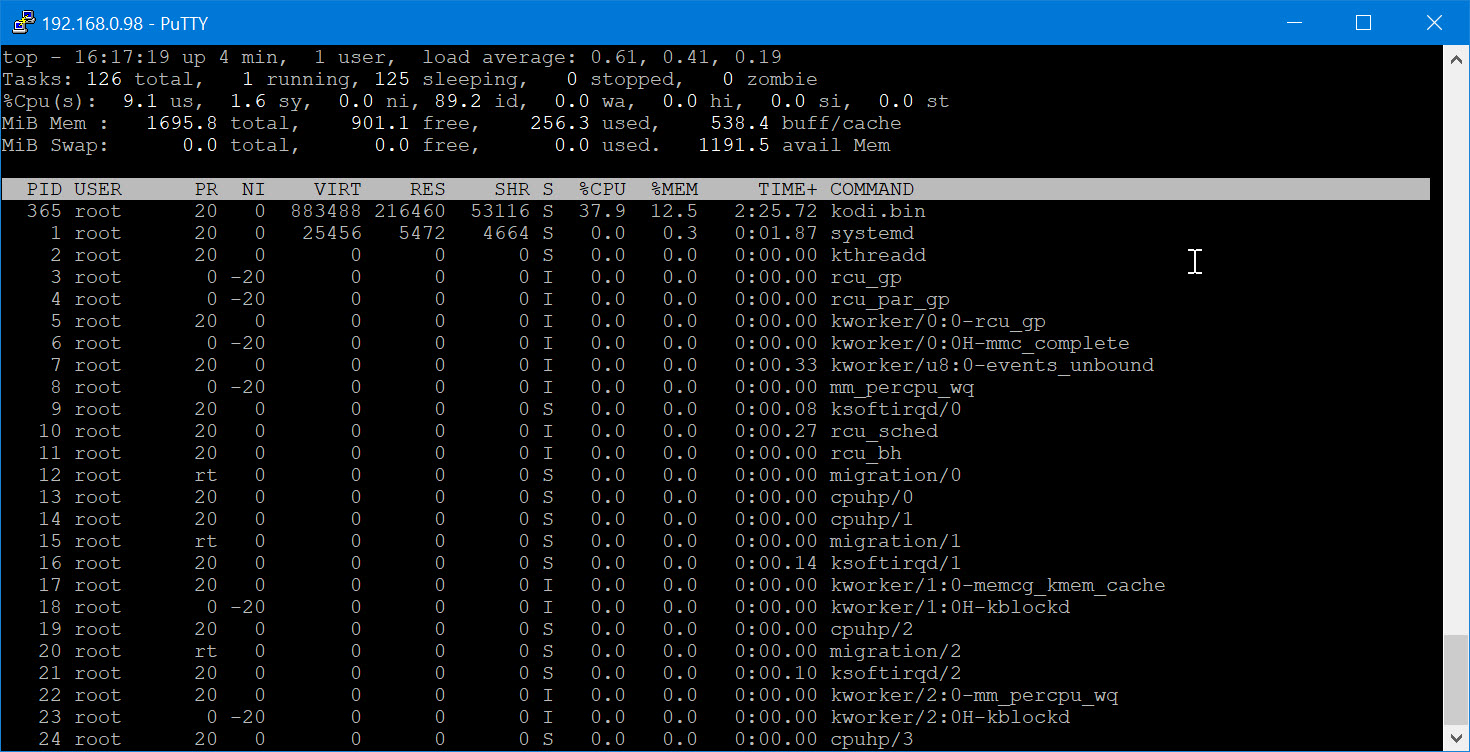

Ok you're right I should have said a bit more. What was running... well I posted the screenshots. Nothing.
I know the Pi gets warm and I had that problem before, but not literally in idle. What is a bit weird is that cpu consumption is only around 40%.
With the case not closed (Front door open) and no heatsink it should not get over 80 degrees right?
This is a replacement I got the other day and I have not installed a heatsink yet, but I had one on the old one and that didn't do much, maybe 2-3 deg.
The PI is running without a monitor connected. Maybe that's why;)

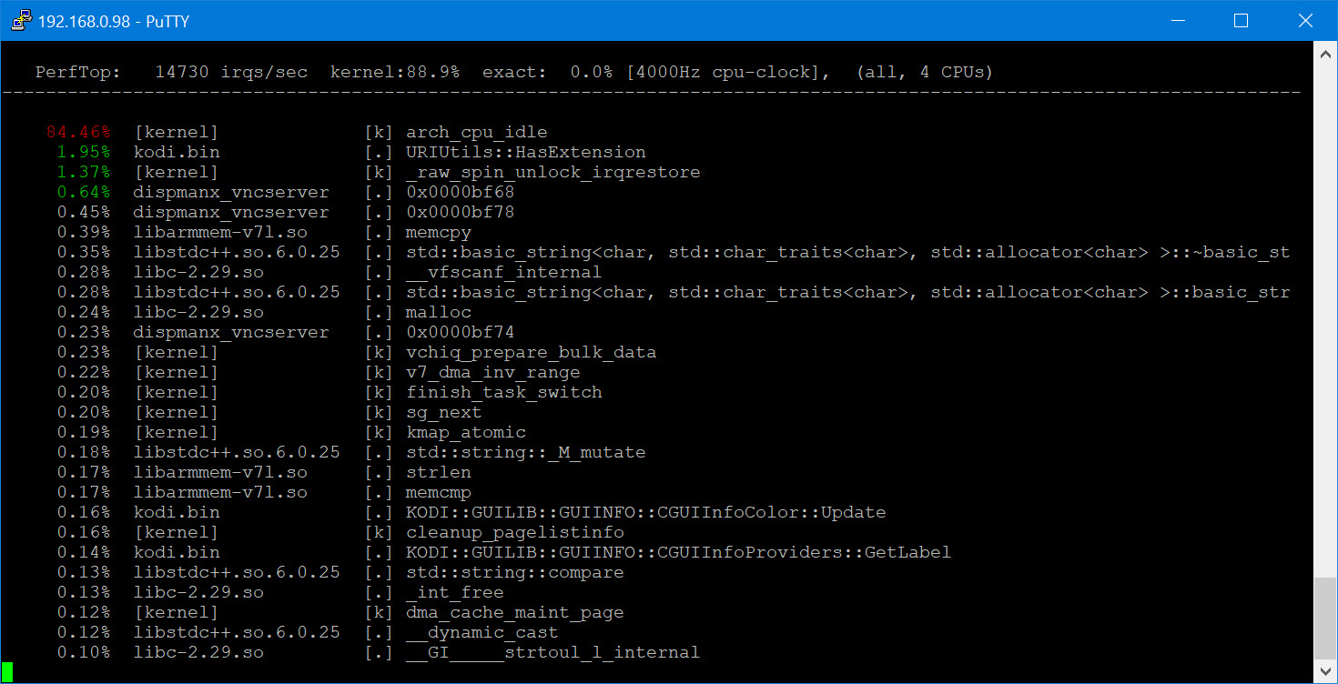

At idle Kodi should be running at ~20% CPU - using VNC increases this somewhat. However, your bcmstat figures are very high. At idle the RPi4 should be 600Mhz arm 250Mhz core.
I suspect a rouge add-on. What add-ons have you installed apart from VNC?
What does dmesg and kodi.log look like?
