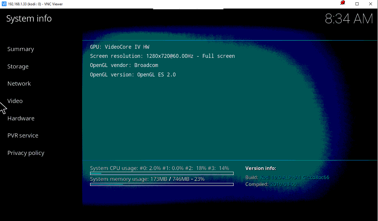

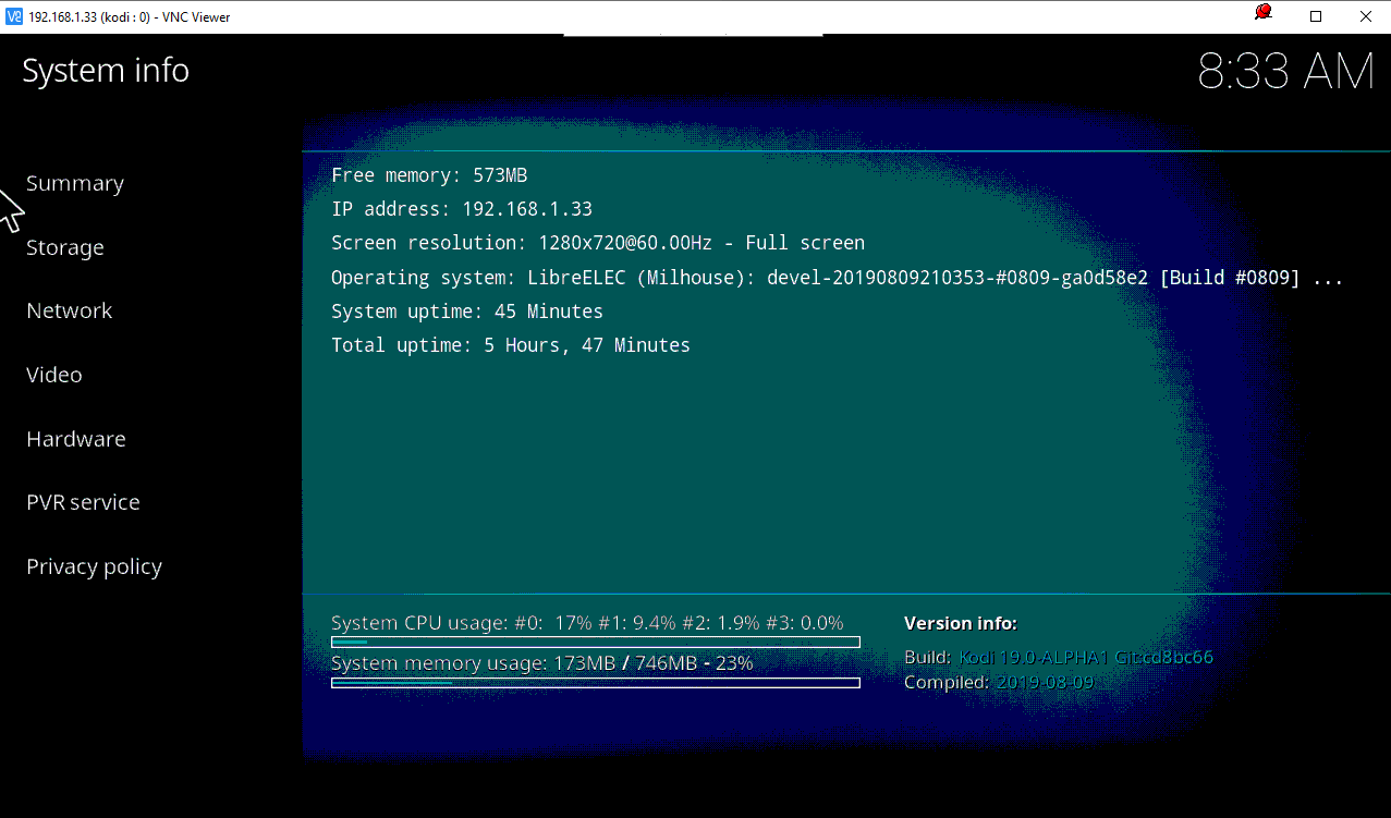

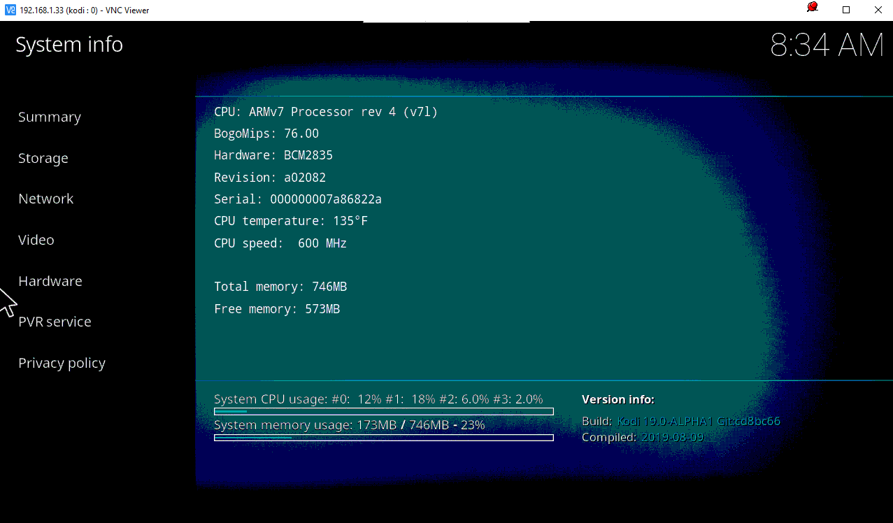

    • Description: I installed libreelec 9.1.002 (stable) and after first boot I updated to the version above. I needed, because my DVB-C dongle has correct firmware only in kernel 5.0 or above. and it works :) . I have set up TVheadend and I was happy, but watching HD DVB-C stream for a minute, the pi starts shouting about it's temperature. After a minute watch the temperature went up to 179 F degrees. I have a passive cooling sink on both GPU and CPU. I never experienced this quick heat rise. The sinks itselves was quite hot. The idle temp is 135 F. During stream playback the cpu usage was not more than 20-40 % per core. If you need any more information, I'm happy to help.
