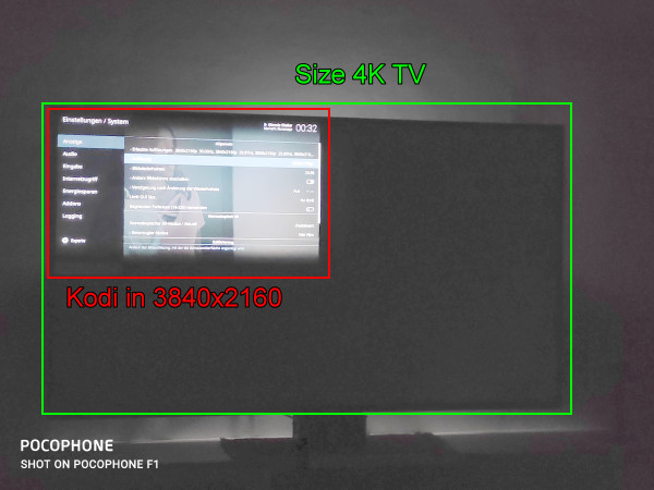

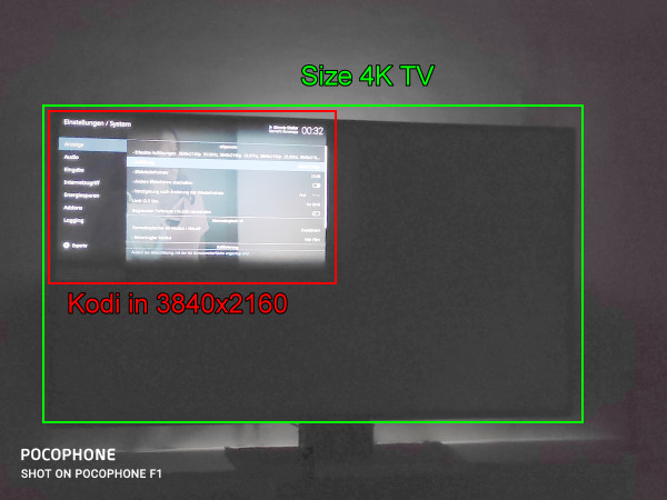

    While manually forcing edid.dat files, I realized another problem. The max resolution my RasPi scales seems to be 1920x1080. All above ends in a small unscaled picture on the TV. If scaling is done by another device, everything is correct. Please see attached picture (sorry dark, forgot the flash on my phone). The unscaled picture relates to the GUI and video, no matter which resolutions are allowed and other settings. 4K=1 allowed in config.txt.
    Any ideas?

    2. You can choose resolution for each file in the submenu while already playing. But when I change this, let's say I play 720p and change it to HD or UHD, the screen doesn't render it 100% but i see only a small picture in the top left corner. I don't know, if Kodi, AV-R or LG-TV is the problem. If I restart the file, Kodi remembers the new forced resolution, but only to 1920 and gives me a full-screen picture.
