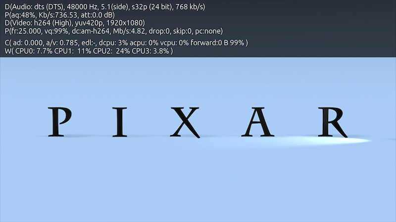

I checked the file again. It plays flawlessly on the earlier version, and even on S805 libreelec. The new version has big trouble with it. I cut a 20MB piece from the beginning, that exhibits the problem on my wetek hub when played from a gigabit connected smb share.
Link: File-Upload.net - Datei nicht gefunden
Back to earlier version...
Edit: Now I cannot get the file to work on any version. I am too tired today, will do more tests tomorrow...
Less tired, more cohesive: The file plays fine on S805 Libreelec, Libreelec x86 8.0 (Nvidia ION) and on Kodi/Windows 10 - all with hardware decoding. I could not get S905 Libreelec to play it, so I must have been mistaken that it worked on a specific version. I tried 008-fix, both 20161018 devel and the 20161023 devel versions on the wetek hub.

Just tried that file via USB and played fine.
Tested Nexbox A95X S905 1gb / 8gb
LibreELEC-S905.aarch64-7.0-devel-20161024175728-r23406-g57856b7.img.gzInteresting, I use the same version on the hub and it does not work for me, even when on USB. It shows neither the stripe over the castle nor the lamp jumping around; instead, the picture is frozen.

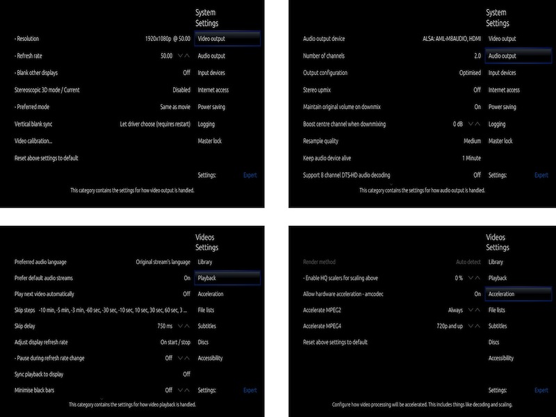

Could you take a picture of your video and sound settings? Maybe there is a difference.
Thanks for testing!
Could you take a picture of your video and sound settings? Maybe there is a difference.Hope this is enough info. Let me know.
