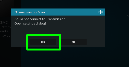

    It installed with 3 mandatory components, but fails to launch when I click on the icon tile. Returns an error that it couldn't connect and asks to open settings dialog ..

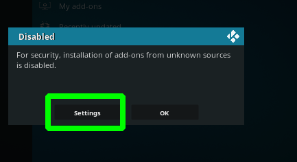

    I've uninstalled the "official" Transmission add-on and downloaded the service.transmission-9.1.16.zip from Thoradia repository on Github, but when I try to "install from zip" on LE 9.01 add-ons page it returns error msg that installing from unofficial sources is disabled :(

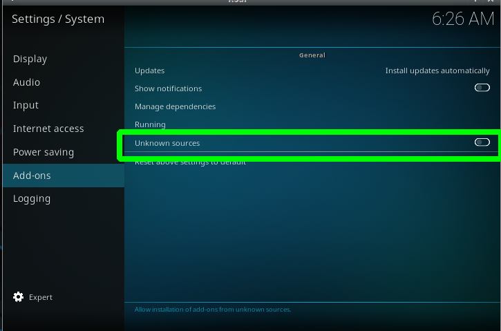

    Have you ever considered to follow the message you receive for the "unknown sources"
    If you click on that ^ you will be pointed to:
    So, I have a question towards you....what is the bloody point of an error message if you refuse to read it properly

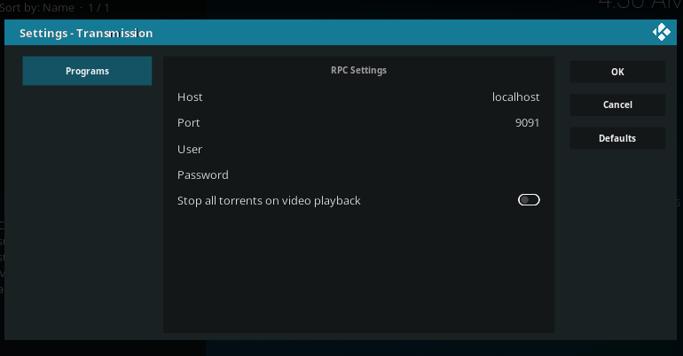

    Regarding your initial question about the transition add-on and the settings-dialog:
    Have you ever considered to simply configure the add-on to work properly. Why on earth would you think that the same add-on from another source would behave differently? If you would have hit "Yes" on the above dialog, you would have seen that:
    Maybe you should learn how to read the messages Kodi shows you. But I even don't think that you will read this posting properly. So don't expect further help in here if you refuse to read.

    No, I haven't tried to disable "disabling" message by clicking on [settings] - but I will try that, to install Thoradia add-on from zip.
    On the "Unable to connect to Transmission " - Yes I went to settings and tried different user /password, and replaced "localhost" with IP, but to no avail.
    In fact, transmission-service was not even installed in init.d - the Transition add-on installed from Kodi library is an empty shell.

  • All right ... success! Thank you Iridium for the tip on overriding the "unknown sources disabled"

    3) Once Transmission installed on LE, go to My Add-ons > click on Transmission tile, go to Settings and update the IP of your local network ending with x.* Leave all other defaults as is
