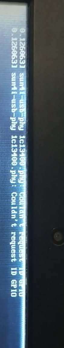

    I finally found and charged my inet97 tablet and tried the image.
    Unfortunately the boot up stopped with the statement regarding USB. See attachment.
    Once boot stops there the screen gradually turn more and more into extremely bright and uneven white.
    Not sure what it could be
  • such issues are usually caused by wrongly set clocks. I wrongly assumed that this is tv box and enabled hdmi. Maybe hdmi driver messed clocks...

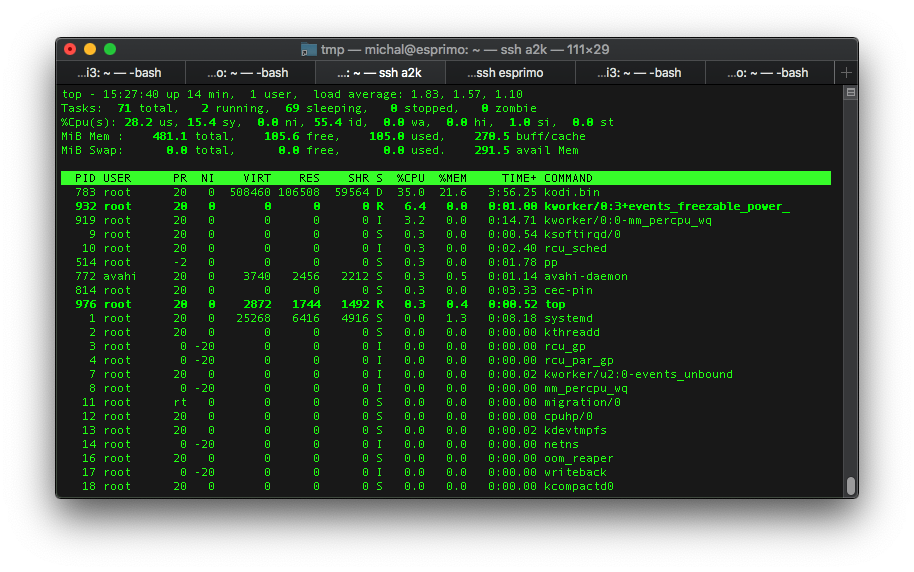

  • No, I don't have any A10 board. However, your statements are contradictory. Link name mentions broken H264 decode but you linked to error message which clearly come from GPU. GPU and VPU have nothing in common. Full HD screen only needs about 8 MiB of memory for GUI (used by GPU). Hard to say anything...

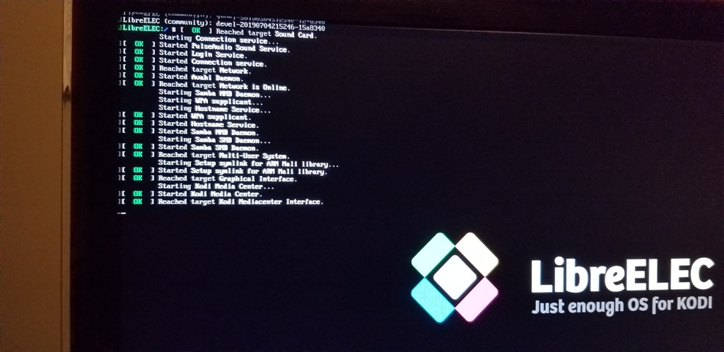

  • Hello all!
    I have cubieboard2, with compiled master branch of Libreeelec.
    When I start cubieboard I see Libreelec logo, then Kodi logo, but after that nothing happen with black screen. I try to ping cubieboard by IP,but no luck.
    1. Can anyone provide link to working image for cubieboar2?
    2. What can be wrong with my setup?

    Without knowing too much I'd suggest to add an usb TTL serial cable to the console port to see what happens.
