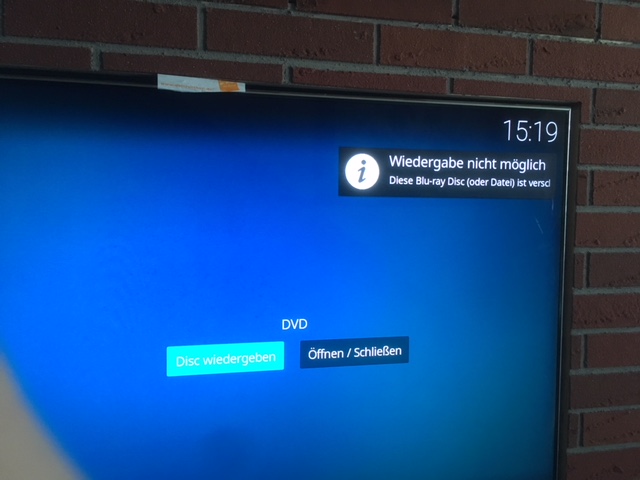

  • so i have the problem that some or all BD+ movies like (Logan) not can be decrypted, i allways get the Message can't play encrypted videos...
    under LE 8.2.5 it works great
    i use the makemkv plugin 1.14.2 the UHD Disk from Logan works, so the Issue must be in the BD+ part from Kodi, i tried it with and without "bdplus" folder, Logan BD not work

    here the logfileand a picture

  • you don't understand, BD+ don't work for all movies! It don't work with an clean installation without any addon and it don't work with addon
    Es funktioniert nicht bei einer frischen Installation und funktioniert auch nicht mit makemkv
    the not working Movie is "Logan"
  • do i am the only person on world who looking BluRay's? please can someone try to fix the ploblem with bd+ and Blu-Rays? one movie what not work is Logan (from the 4k Bundle) I can't look this movies with LE 9.x
    only with LE8.2.5 do all blu-Rays work. but there my grafikcard with audio path-trough not work :(
  • This makemkv addon works on LE 9.0.1:
    [Addon] MakeMKV
    Remove old version first, install the addon and start it(Important!) to update the key, reboot
    Try to play through the file menu, not the disc menu
    I added instructions to the thread
