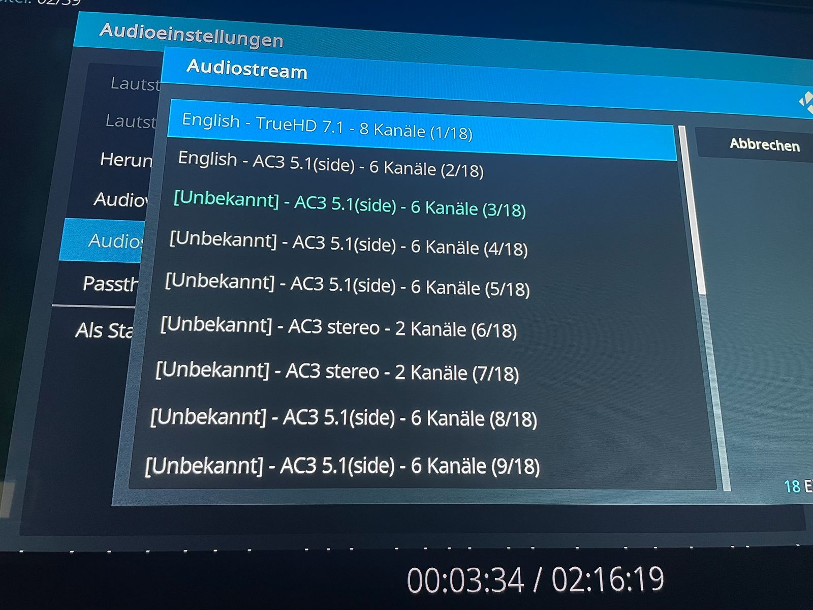

    The Issue what i have is this one, my System is everything on German, so when i play a BD or UHD Disk the audio and subtitle track should be the German one, but allways the Englisch track are used for audio, for subtitle are all unknown
    this is so couse the German Audio Track is not named look at the Picture
    under LE 8.2.5 there worked it right the Test-Movie are allways the same Logan UHD or Logan. the Picture is from the UHD one couse the normal does'nt work (look @ other Posting BD+ Problem - LE 9.0.0)
