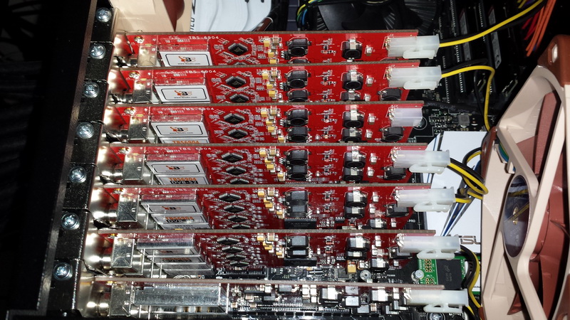

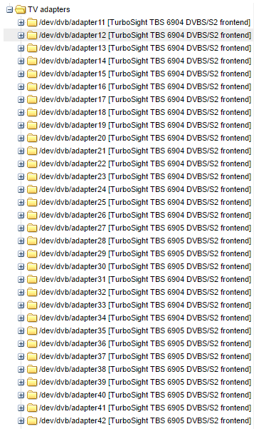

I made a server with 7 cards. It was TBS 6904 and 6905 (quad-cards) back then.
Now we can install 6 or 7 TBS 6909 octa cards in the standard motherboard.
And there is extreme server with PCIe splitter and total of 8 PCIe cards. It was setup on OE6 back then with TBS-Crazycat drivers. And max adapter_nr was 64 in that build.
There is additional reason to have higher numbers available.
I set adapter numbers from 11 upwards instead of 1 upwards, because in other case adapter number 2 would be after 19 and number 3 - after 29, so card inputs would mix up in the list.
Now SAT>IP server in tvheadend is working OK, so probably no need to use PCIe splitter, but 6 cards in the server is easy to do and very useful.

It is simple, no need to have lots of adapters ![]()
Just one DVB adapter and try to set different adapter_nr for it and reboot.
When setting a number higher than 63, for example, 64 - the adapter gets number 0 instead of 64.
Now it is the case with numbers higher than 31.
