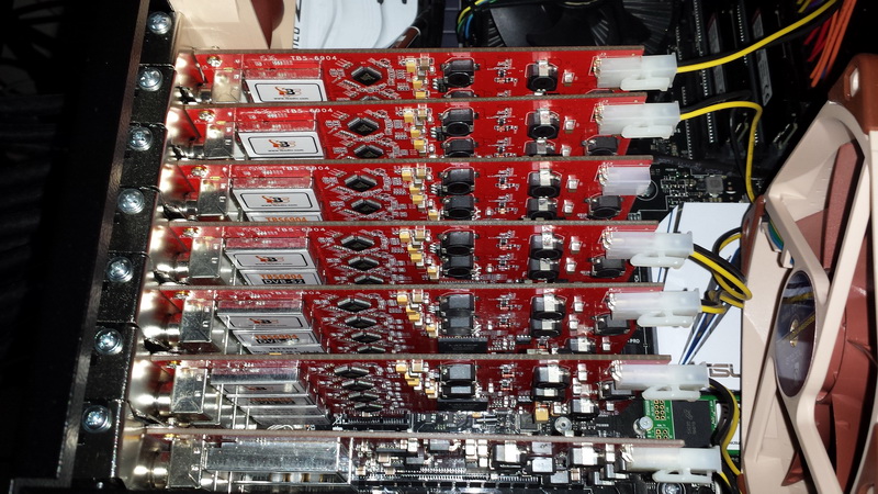

    I made a server with 7 cards. It was TBS 6904 and 6905 (quad-cards) back then.
    Now we can install 6 or 7 TBS 6909 octa cards in the standard motherboard.

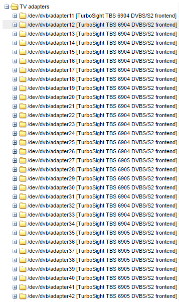

    I set adapter numbers from 11 upwards instead of 1 upwards, because in other case adapter number 2 would be after 19 and number 3 - after 29, so card inputs would mix up in the list.
