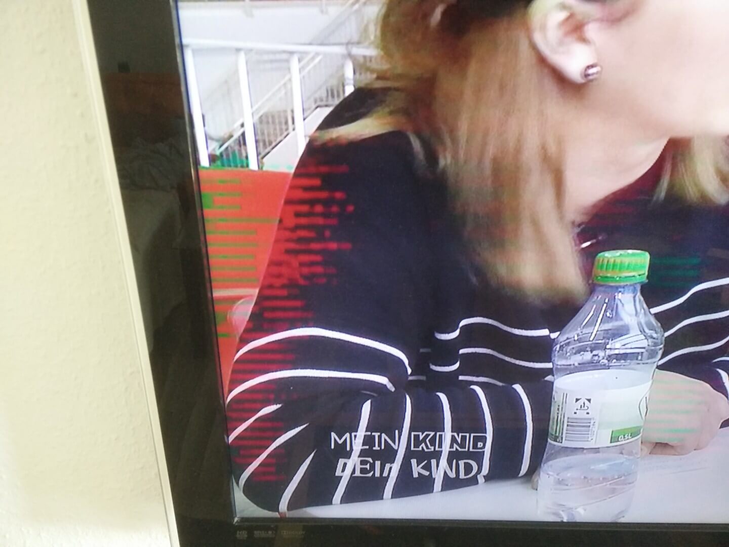

  • Maybe someone have an idea. I have an Alphawise H96 pro plus. When i watch 1080i channels with VDR addon i often have a bad video. Does anywone have this too? Is it graphic driver related? Box broken, overheated or somehing else? I attached a picture. This just happens in 1080i channels. Maybe deinterlacer problem?
    This happens also with SPMC, FTMC, Kodi 16 and 17.

    Two times I received this problem on 1080i video file, so looks like deinterlace code bug. But it occurs on several iptv channels for me only
