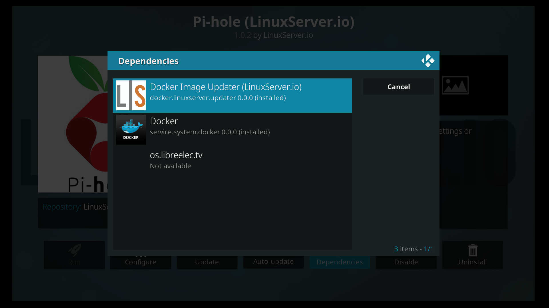

    Installation:
    1) Install LinuxServer.ios repository.

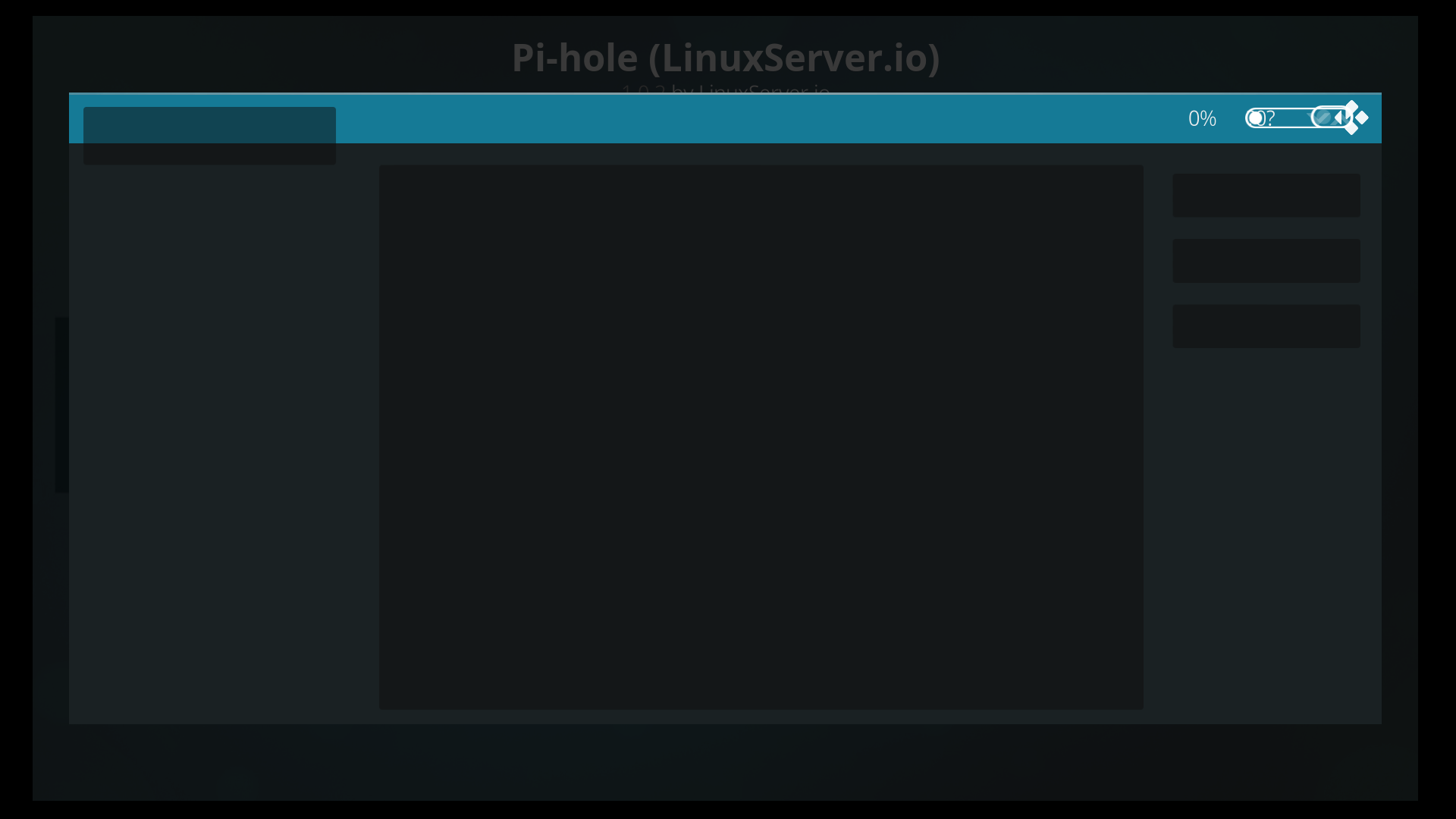

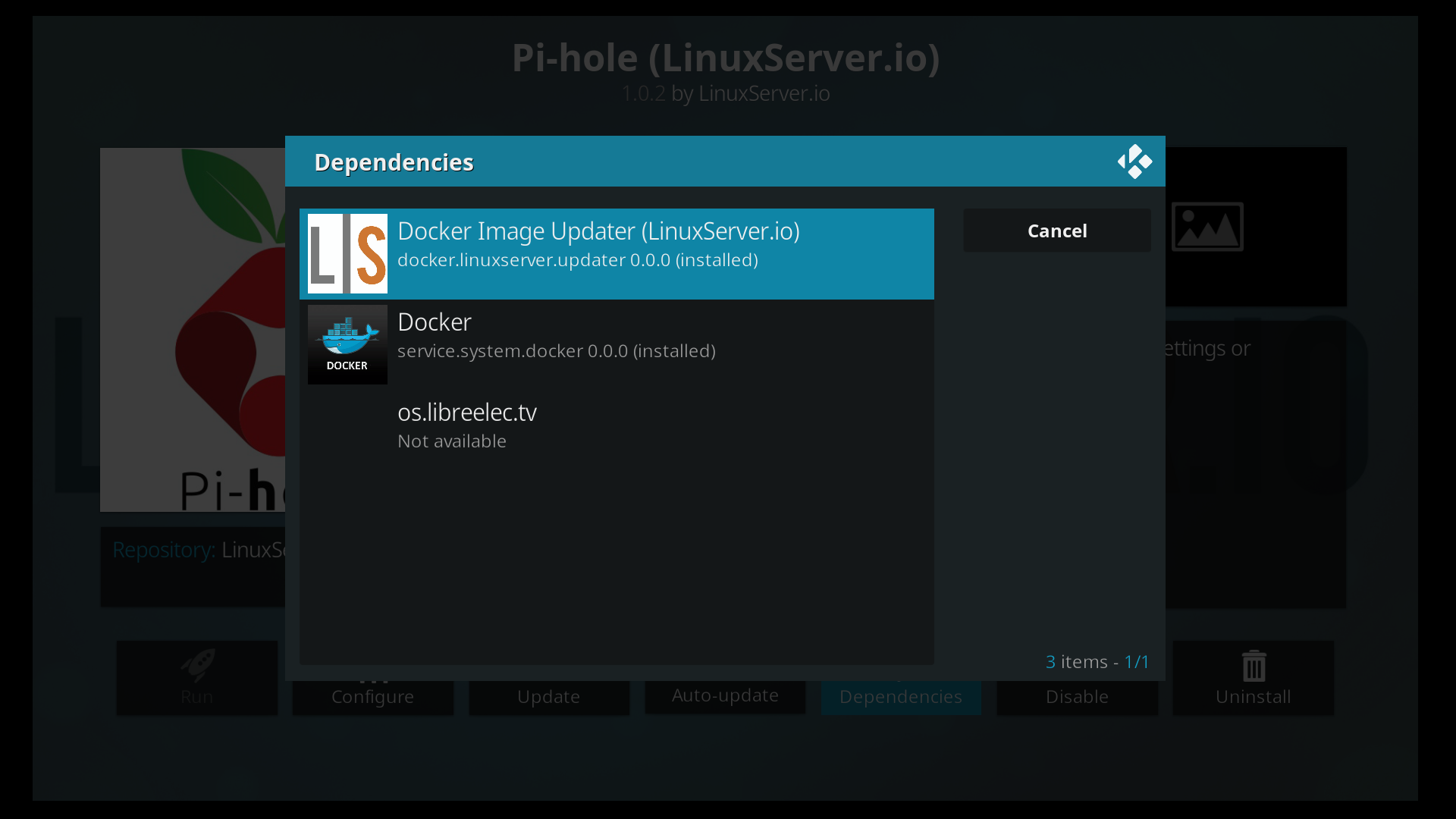

    Add-ons → LibreELEC Add-ons → Add-on repository → LinuxServer.io’s Docker Add-ons
    2) Install Pi-Hole
    Add-ons → LinuxServer.io’s Docker Add-ons → Services →
    (This will take some time, so be patient)

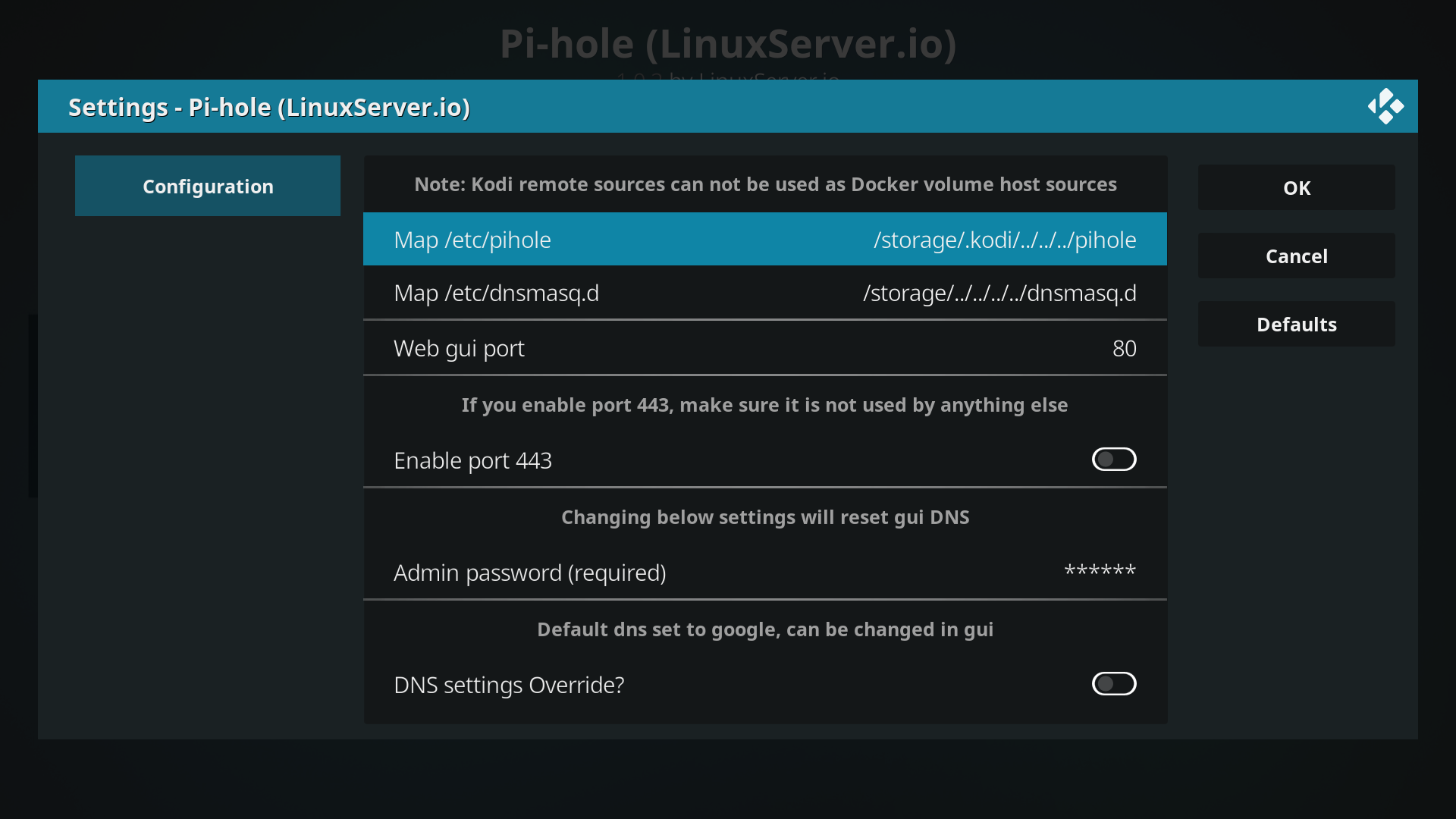

    When finished you will be taken to the Pi-Hole configuration page. All you really need to do is add a password to access the webgui.
    Now wait some more – as the Pi-Hole container needs to be downloaded. (Around 10 minutes on slower machines)

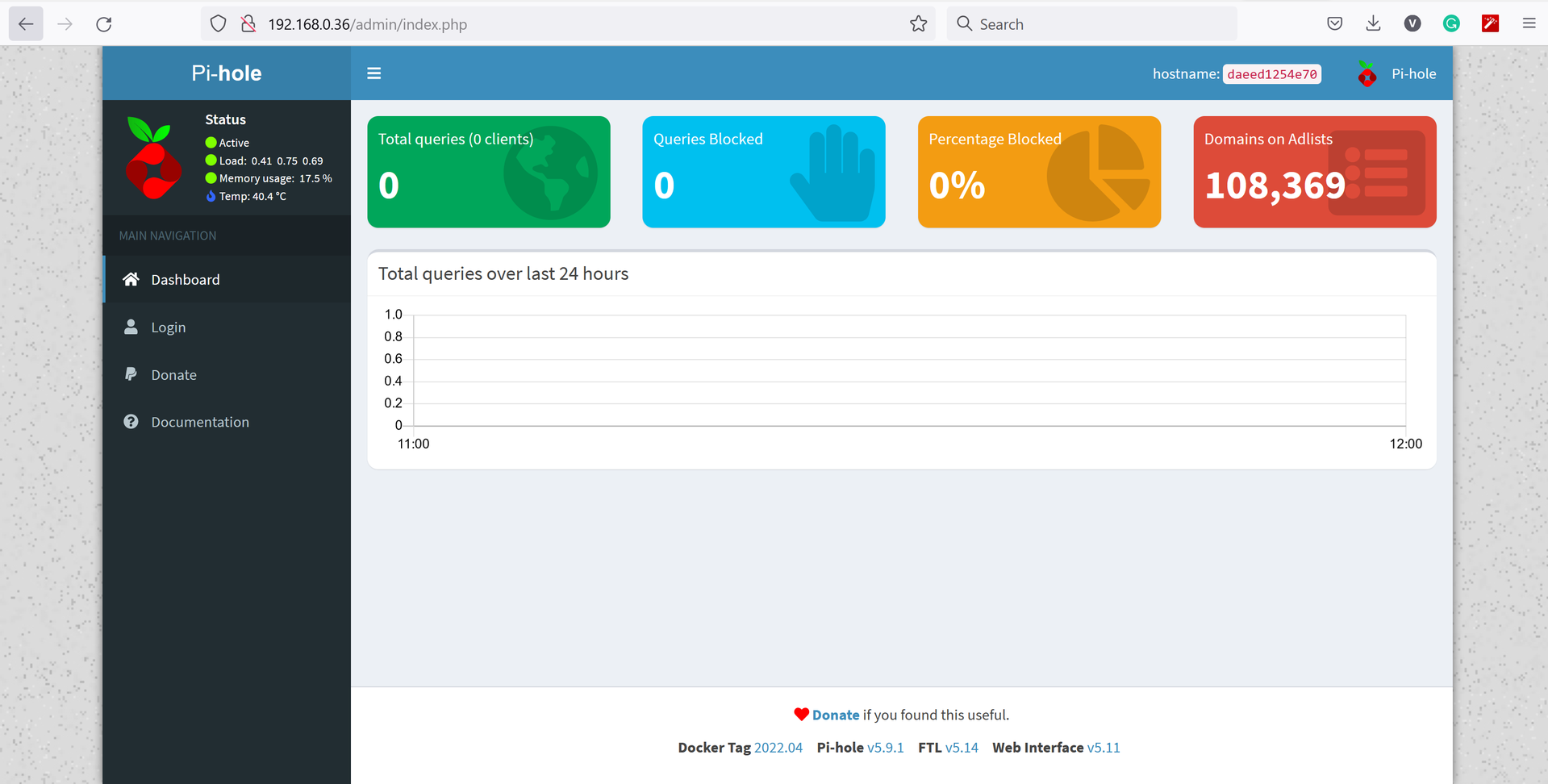

    When all is finished, you’ll be able to log on via the webgui at <IP address>/admin.
