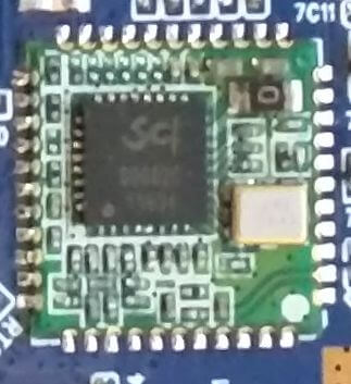

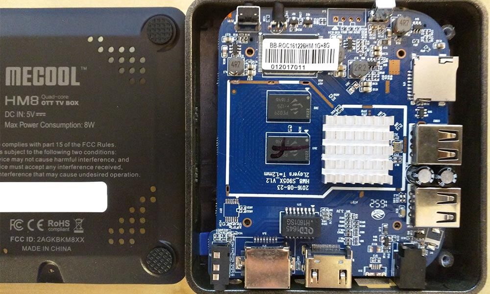

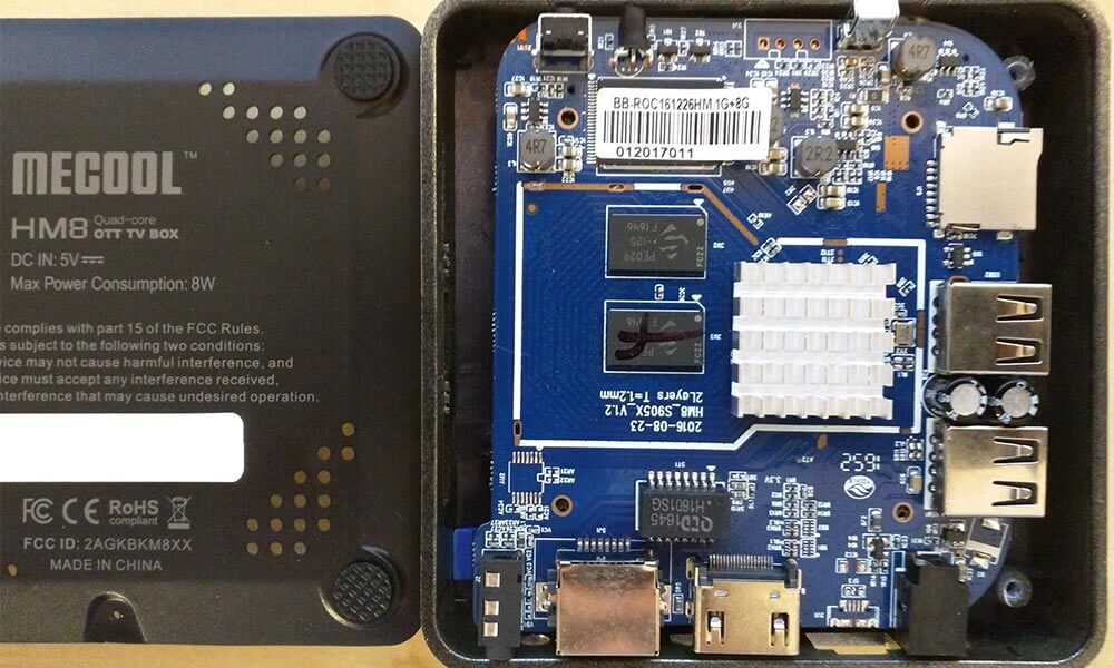

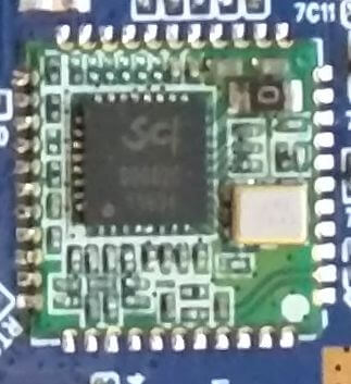

    The first somewhat popular model I've purchased with odd hardware is MECOOL's s905x version.
    They lable this the "HM8", it's a standard 1g/8g eMMC but it uses a straonge "Sci" WiFi Chip (Chinese brand: sci-inc.com.cn )
    It also won't mount any partitions local to the device with the 3.0.2 TWRP that works on other s905x boxes.
    Here's a phone and one close-up of the WiFi (not legible, but best I could get with my phone).
    Anyone else have any experience with this / any special dtb or something as a workaround?
