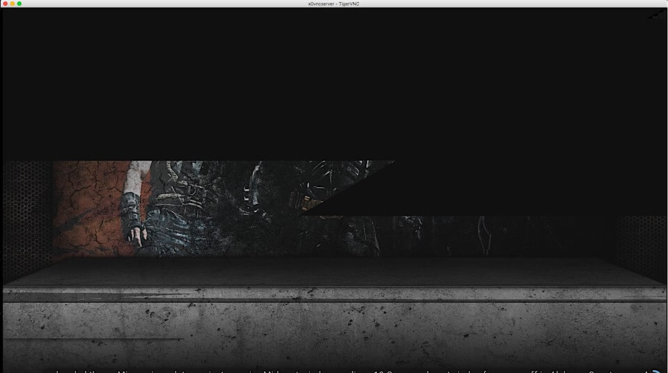

I'm trying to get TigerVNC working but when I try to connect from another machine I'm prompted for a password. There isn't any password setting in the addon configuration. Not sure what I'm supposed to enter for the password?
What password for TigerVNC and video tearing issue.

No. Not trying to watch videos over VNC. This is just needed for adjusting settings without having to tie up the living room tv for extended periods and listen to a bunch of "are you done yet"
The tearing doesn't really prevent that but it's very annoying waiting for it to settle down every time the image changes. Was hoping I could get VNC working a little better.

I m assuming and I might be wrong that TigerVNC is sending picture frames to the PC that's why it looks like it's flickering...you might play a bit with settings perhaps there is a setting you can increase the frames it sends but it might slow up your system..
If you are using Intel graphics on your PC, then it is a problem with the Intel driver used in the 8.0x builds. More info here: VNC Add-on.
Thanks, but it's a Nvidia GeForce 8800 GT.
