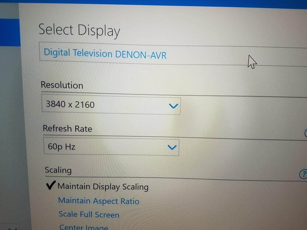

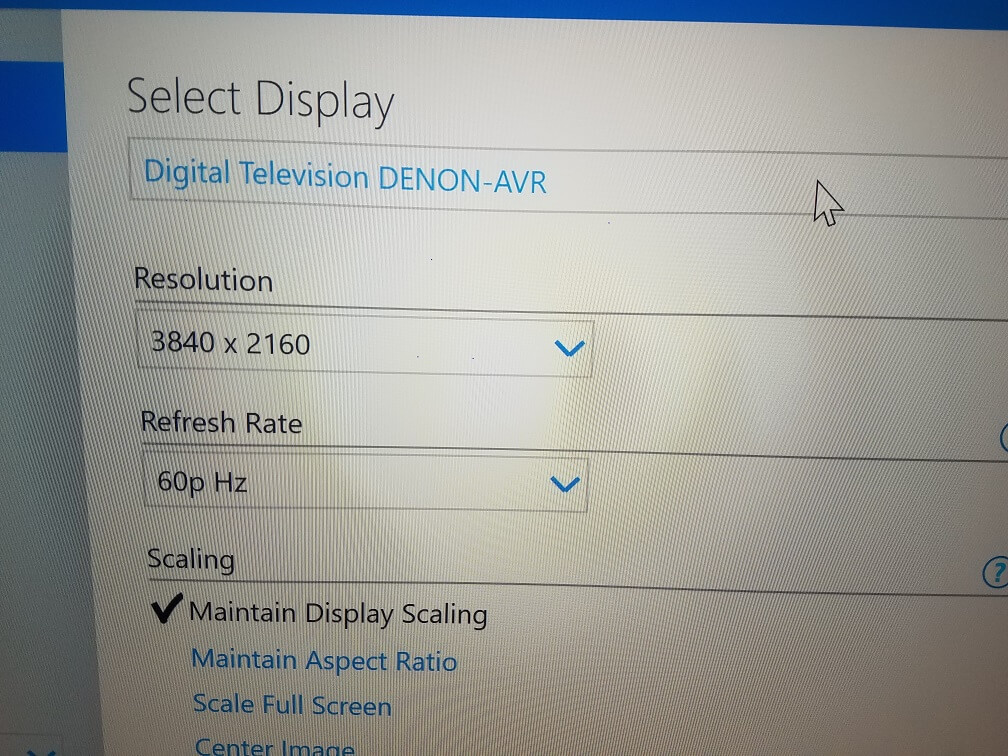

  • I am having a 4k issue as well. I am not seeing the 60Hz refresh and when i play movies from one of my out of network servers, I cant get the 4k to remain steady. I get jerky video and audio does not match up. I am running a Intel NUC6i5SYH with Libreelec and Kodi with Plex add on. When i play movies that are 4k on my internal network it works (some movies no 60hz)
    Any ideas? I am not a programmer by any means but can follow directions if explained to me.
