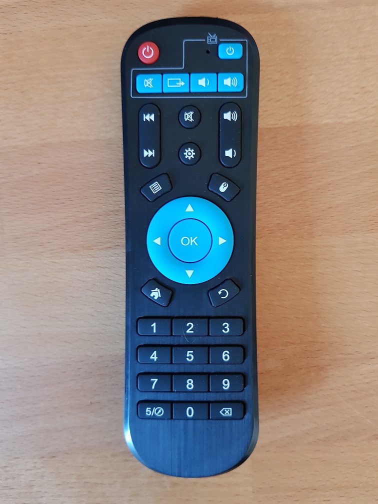

    My question is... the remote I'm using it the following remote. But it's not working that great anymore. Some buttons don't react every time I use it...
    And I would like to have a remote with some more function-buttons so I could program them to do some other kodi-functions.
    I have a few questions...
    Can I just buy an other remote? What remote do you guys advice? How do I get kodi to recognise the remote?
