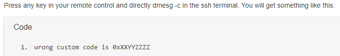

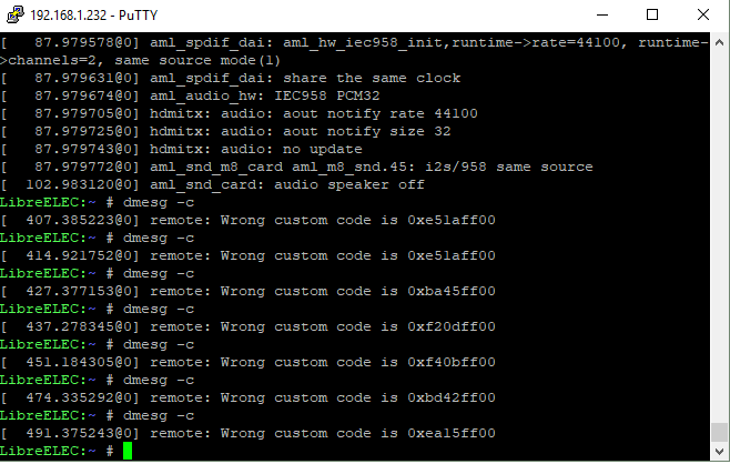

    I do everything like in manual, but when I send dmesg -c, I got different kodes in reply, depend of the key I press on the remote.
    remote: Wrong custom code is 0xXXXXff00 (XXXX is changing depending of key)
    So I can't get factory code.

    I turned on my device, I had my laptop next to it, opened putty log in as root, password libreelec. I then typed in the instructions, to stop kodi, then pressed buttons on the remote, & made a note of the codes.

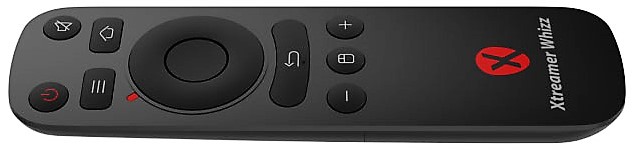

    I'm still looking for remote.config for my Xtreamer Whizz with LE 8.2..
    I have tried many that I found in this forum, but only one works partly (only home and back button).
    So I'm a little bit lost how to make it work.

    After few tries it flash up, but now I stuck in LE configuration, because remote is not working.
    I read a lot at this forum and download several remote.conf.
    With computer I access Whizz, found Configfiles folder and copy remote.conf one after another in that folder.
    I unplug Whizz from outlet and plug it back every time to make restart.
    I can't make my remote to work.
