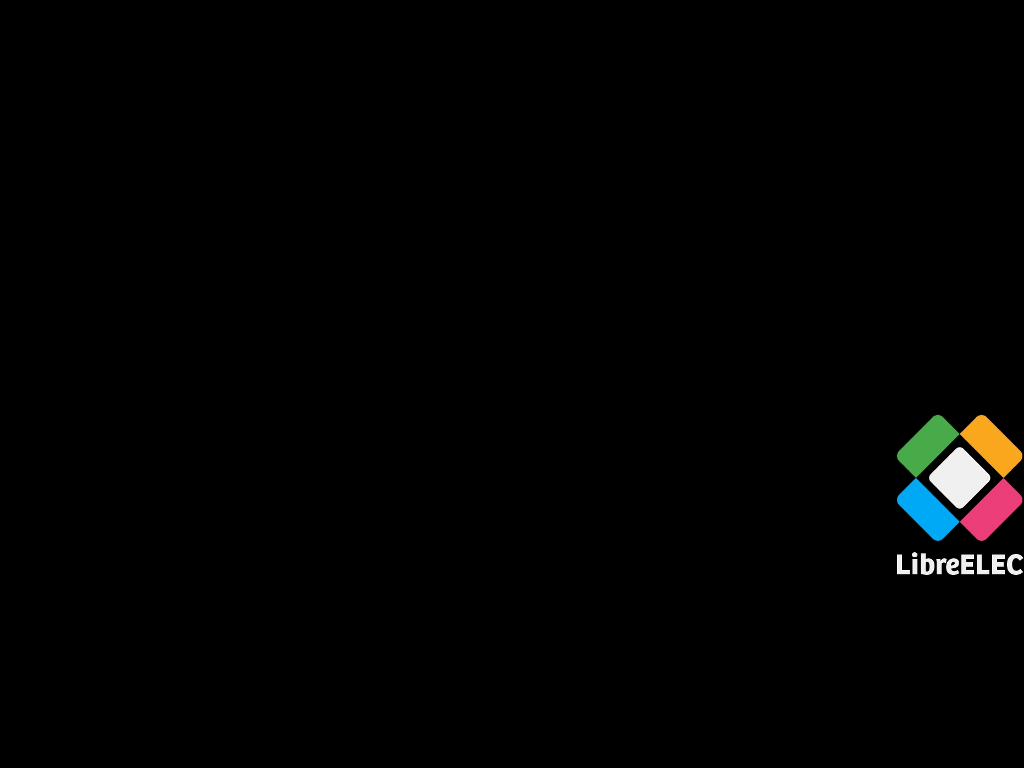

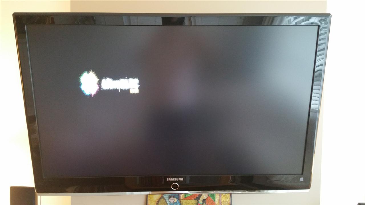

  • When booting up my x86 box running the latest LibreElec 7.95.1 (same thing happened with all 7.90.x versions), the boot or splash screen LibreElec logo is not shown in fullscreen, and is instead shown at about 1/3 the proper size aligned to the top-left of the screen as shown in the attached image. The LibreElec screen resolution is set to 1920x1080 @ 60Hz and this works fine. It's only the boot/splash screen that is shrunken. Any ideas how to resolve this?
