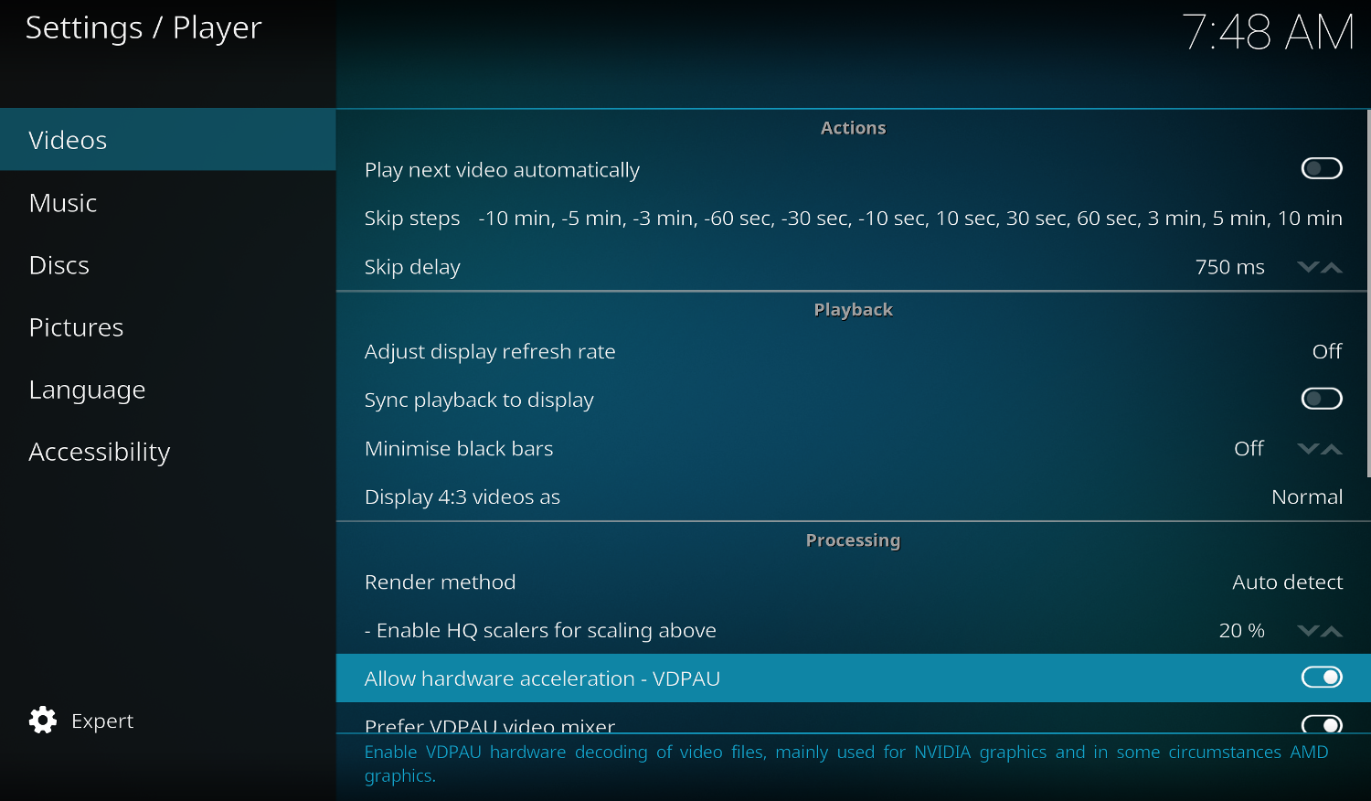

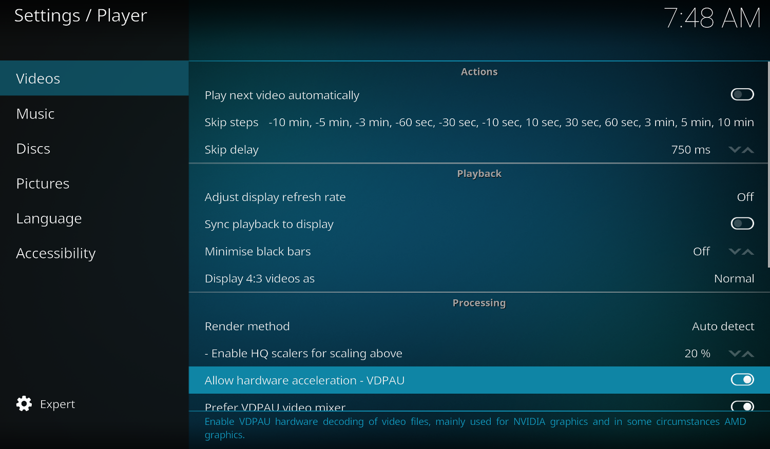

how can i disable VDPAU?
@Irusak
Here my hardware.log
################################################################################ - Pastebin.com
Intel(R) Core(TM)2 Duo CPU T7500 @ 2.20GHz
NVIDIA Corporation G84GLM [Quadro FX 1600M]
Vdpau is disabled in the kodi settings. You might have to set the settings level to expert to see it.
THX, the movies runs now
