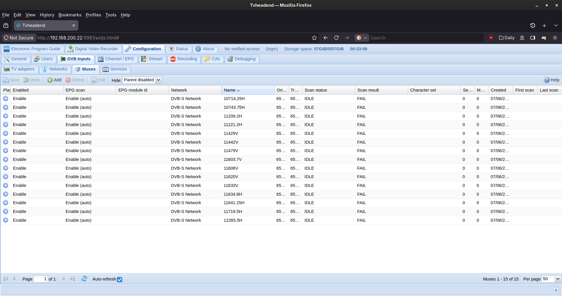

  • I need to set up an clean install with nightly to reproduce an issue/bug.
    I'm unable to find any muxes with last TVH and maybe with new scan tables.
    My environment is an Digibit R1 with 2x Sat-cable.
    Scanning on it's Web-IF => all is fine: 308 x TV, 132 x Radio (FTA only)
    scanning with TVH immediately jumps to 15 found muxes but nothing to map.
    scanned frequencies seems to be un-usual (see attached Muxes.png). Nothing where I usually find my TV channels.
    tried a download/update of the scan tables within TVH settings, though.
    TVH IF-setup is pretty default
    EPG language: German
    astra 19.2
    I tried several times with with sequence:
    1. systemctl stop service.tvheadend43.service
    2. delete /storage/.kodi/userdata/addon_data/service.tvheadend43
    3. systemctl start service.tvheadend43.service
    as said it's an test environment with last nightly installed on an addional disk.
    the environment on the other disk (also last nightly with the same(?) TVH) is okay.
    so I guess something wrong with the scan tables ...
    esp. see the frequencies in the attached Muxes.png and 13.tlist.txt (homebrewed-who-needs-bibleTV- FTA-scan list for my DigiBit from 2025.11.01)
    - I got the same issues with the original Digibit-scan-list (before someone complains ...) -
    I tried to find some of the frequencies (from muxes.png) at https://www.lyngsat.com/Astra-1N-1P.html
    nothing !
    and it seems TVH scans only for that non-existent 15 (see service.log)
    kodi.log is clean

  • some more action ...
    Question:
    where is the stuff under /storage/.kodi/addons/service.tvheadend43/dvb-scan/dvb-s from
    TvH or LE ?
    if I remove Astra-1M I get all of my channels, but with hickups: it hangs for a long time at ~43 %. Never seen this last time (~1 or 2 year(s) ago).
    why did I do that ?
    to me it seems (debugged) that only Astra-1M is loaded, but Astra-1M is dead. even LyngSat doesn't list it anymore.
    1M contains 16 entries, what matches the 15 in the above screenshot.
    also in the scan IF before the scan has started: with 1M only 15 muxes, without a lot more and all services afterwards
    for 1N and 1P it seems there are more or less (cosmetic ???) mistakes:
    - Labels e.g. [Astra TV] and the like
    - no Modulation e.g. [Deutschlandfunk, CHANNEL]
    don't know if the last one is really needed, but I mean scan is speedier when they are there.
    too make friends:
    I offer to fixe 1N, 1P and attach both files when ready or do you own some tools to do it quicker then "visual grep" and hand editing ?
    P.S.
    scan issue can only be seens with a clean TvH, on an complete setup a re-scan doesn't show this issue !
