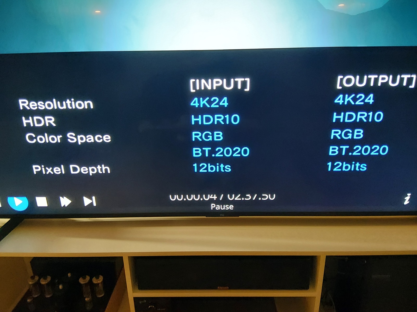

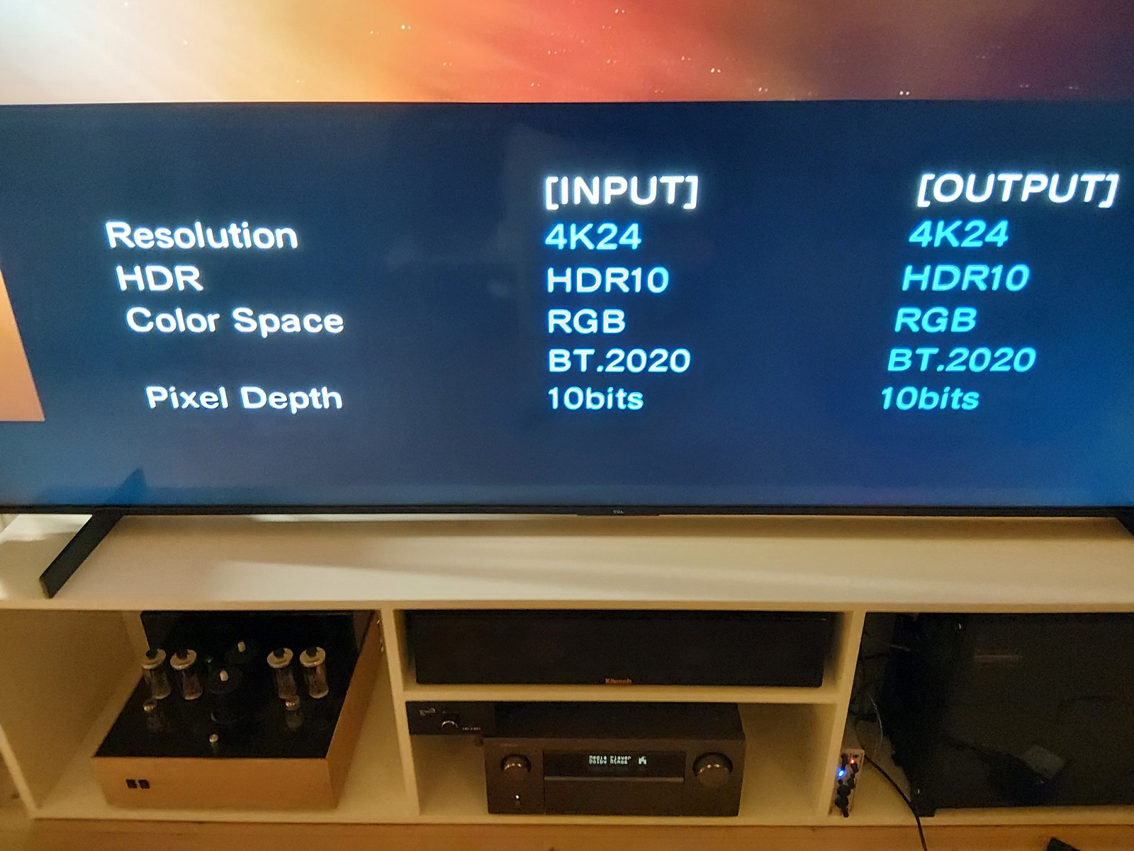

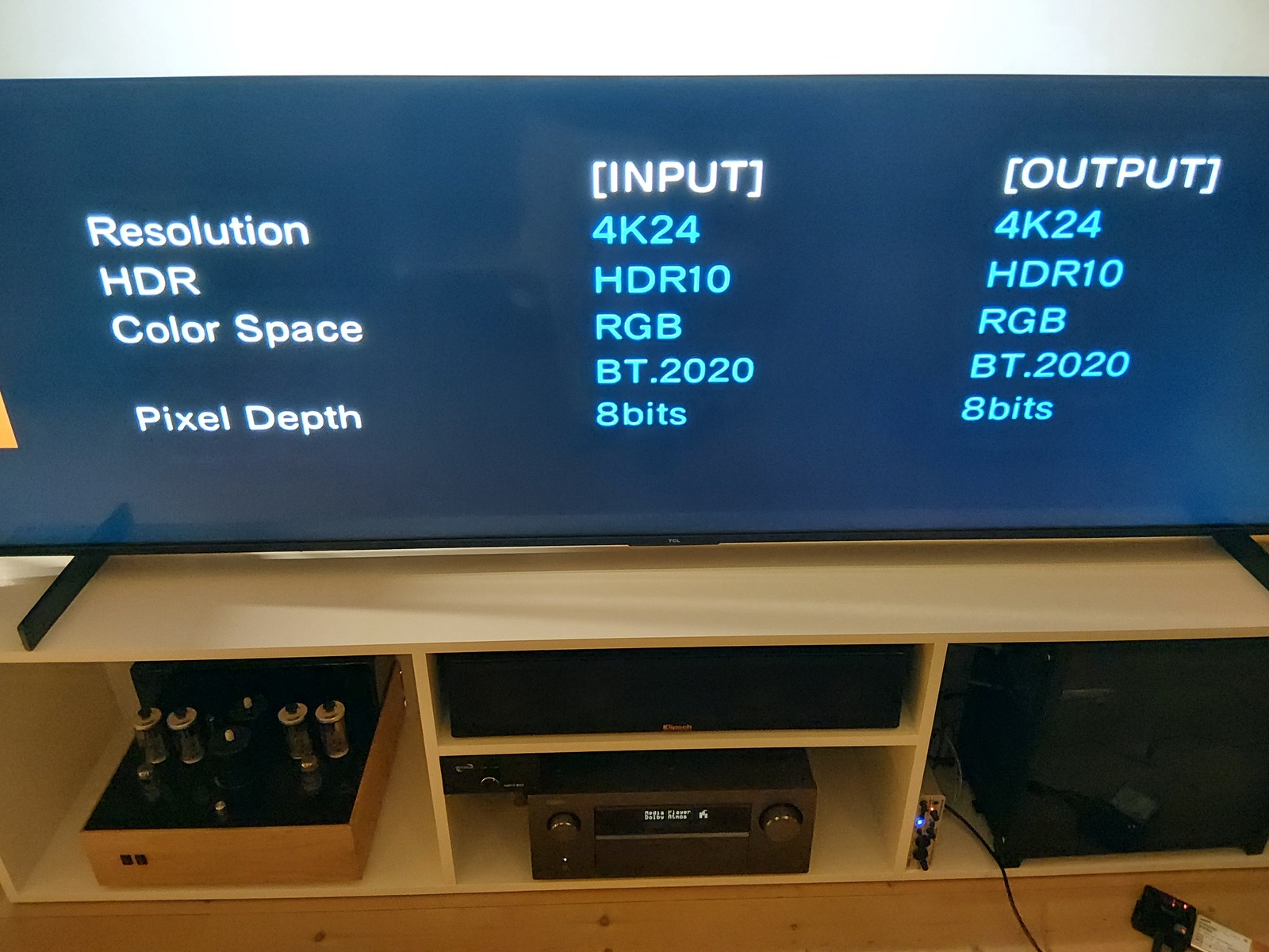

  • Yes, and here is the result.
    I did start same movie every time, and the result is this. I did test it on libreelec, ubuntu, and windows just to se whats going on.
    First test was on libreelec:
    when no hacks are applyed to libreelec, my amplifyer report pixel depth 12bits, and the sound is droping out and are unstable.
    And with the hacks on, and sounddrop is gone, it play with pixel depth 10bits.
    same story is on windows, it plays at 10bits and there is no sounddrop.-
    And on ubuntu it is even lower the pixel depth is at 8bits, and no sounddrop.

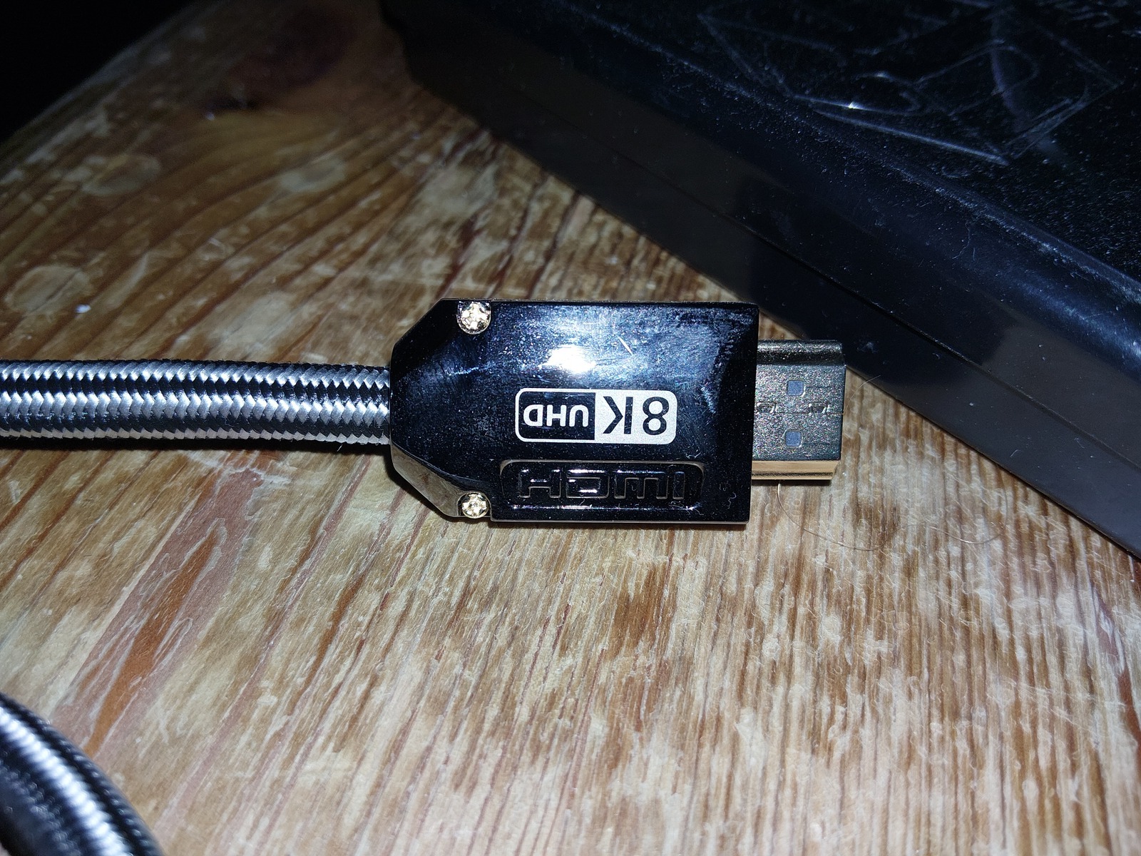

    By the way, do you use a proper HDMI cable? Sometimes that's the bottle neck when data rate goes up.
