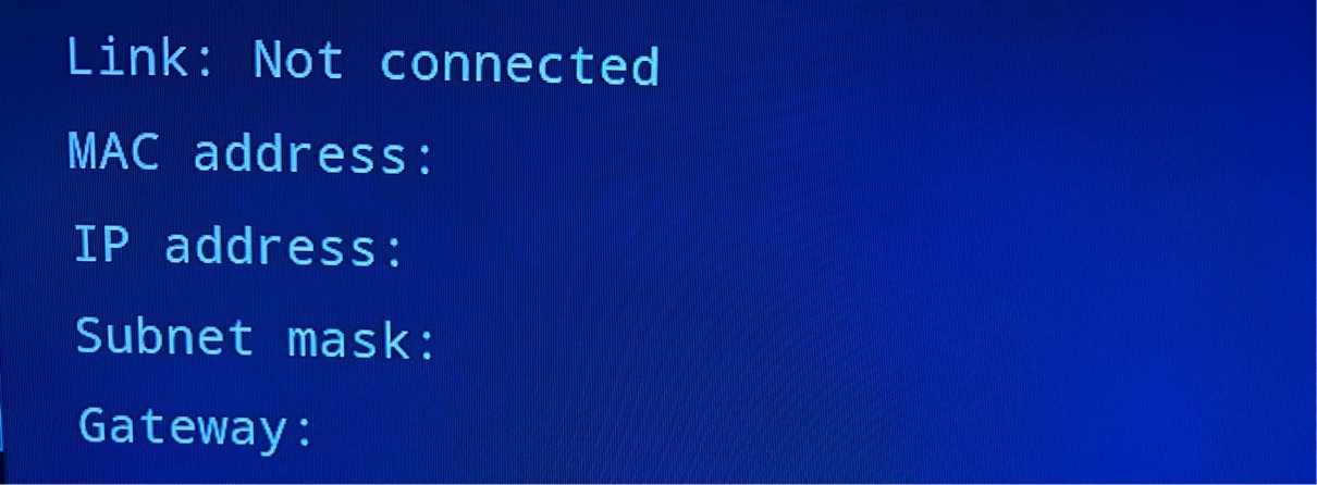

  • I had been running the latest 13.0 nightlies on my Pi5, with 0 issues until LibreELEC-RPi5.aarch64-13.0-nightly-20241021-56c531c
    Booted, and all of the sudden my network was gone. I can see my internet on, and no issues with any other devices in the house. I decided to look at the system info section and go to my network and noticed everything was blank. There is a primary and secondary DNS, I just didn't show it.
    I tried a fresh install of LibreELEC-RPi5.aarch64-13.0-nightly-20241025-9f8eeb6 this morning, and same issue. Nothing is there under system info and network. However WiFi is connected though.
    I also rebooted my whole network just to test that, and that didn't work either.
    Thoughts?
    Thanks!

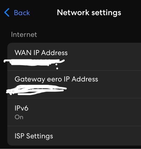

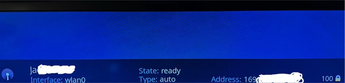

  • My network also shows State: ready, and Type: auto under connection settings along with IP address.
    I do have IPv6 set to on for my eero router as seen in the picture. It has always been on and again, no issues with any nightly up until that IPv6 change it appears.
