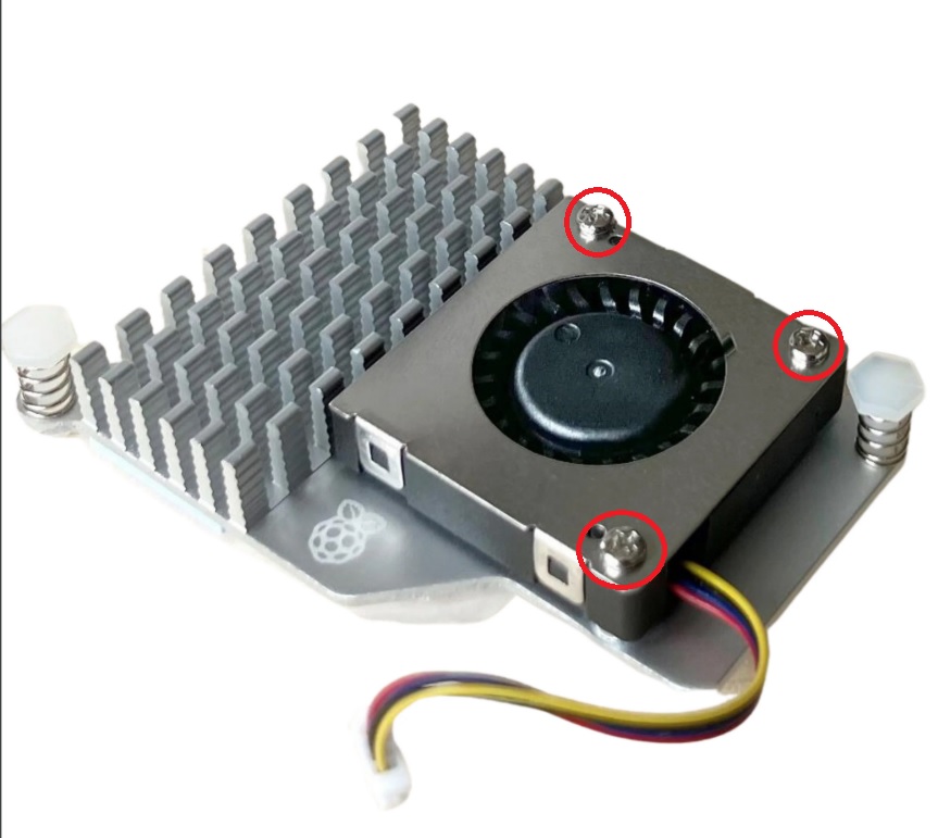

    running Libreelec 11.0.4 on a Raspberry 5 with official case. This case has a cooling fan. This fan is running all the time. Even at 35 degrees system temperature. Its way too loud to use it as a media center anymore. How can I control this fan??? Thx
  • If the fan only has two wires, then it's just an on/off fan. If it has at least three, then fan speed control is possible.
    I assume Raspberry Pi OS has instructions for the official RPi5 case. So search on RPi OS forum first. If you find something, come back and post a link. Usually we can adapt it for LE.
  • The fan has a 4-pin connector (5V, GND, PWM, RPM/pulse sense input) - like standard PC fans.
    DT params to adjust the fan temp/speed curve have just been added to the RPi kernel, I'll update the kernel in LE soon so it'll be available in nightlies - hopefully in the next few days.

    Thank you so much in advance. Then I reconfigure my RPI5 and install the latest nightly build. Then I can already try the LE12.
  • Problem solved. Very sorry. Installed LE12 nightly. This did not help. I read again, that it should be a 4-pin connector. Mine had only 3 pins. So this was a broken connector. Maybe its so fragile, that I damaged it. I repaired the connector and now it works.
    Thank you all for responding!
